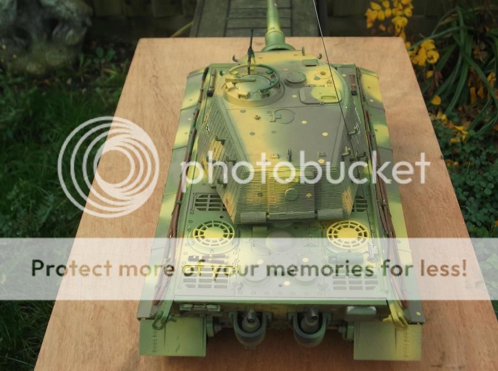

Hi dug, i too have a cammo matorro kt, i had a look inside mine and yes all the wiring seems to be in plug connections like the rx 18 hl, i dont know if the motors are same draw as hl ones and if they would fry an rx18 board. to be honest i really like the matorro kt despite the bulge on the front glacis plate and older electronics, you dont see many about now. if it was me i would keep it and upgrade the internals.this is mine,
good luck with yours
Regards stuart
