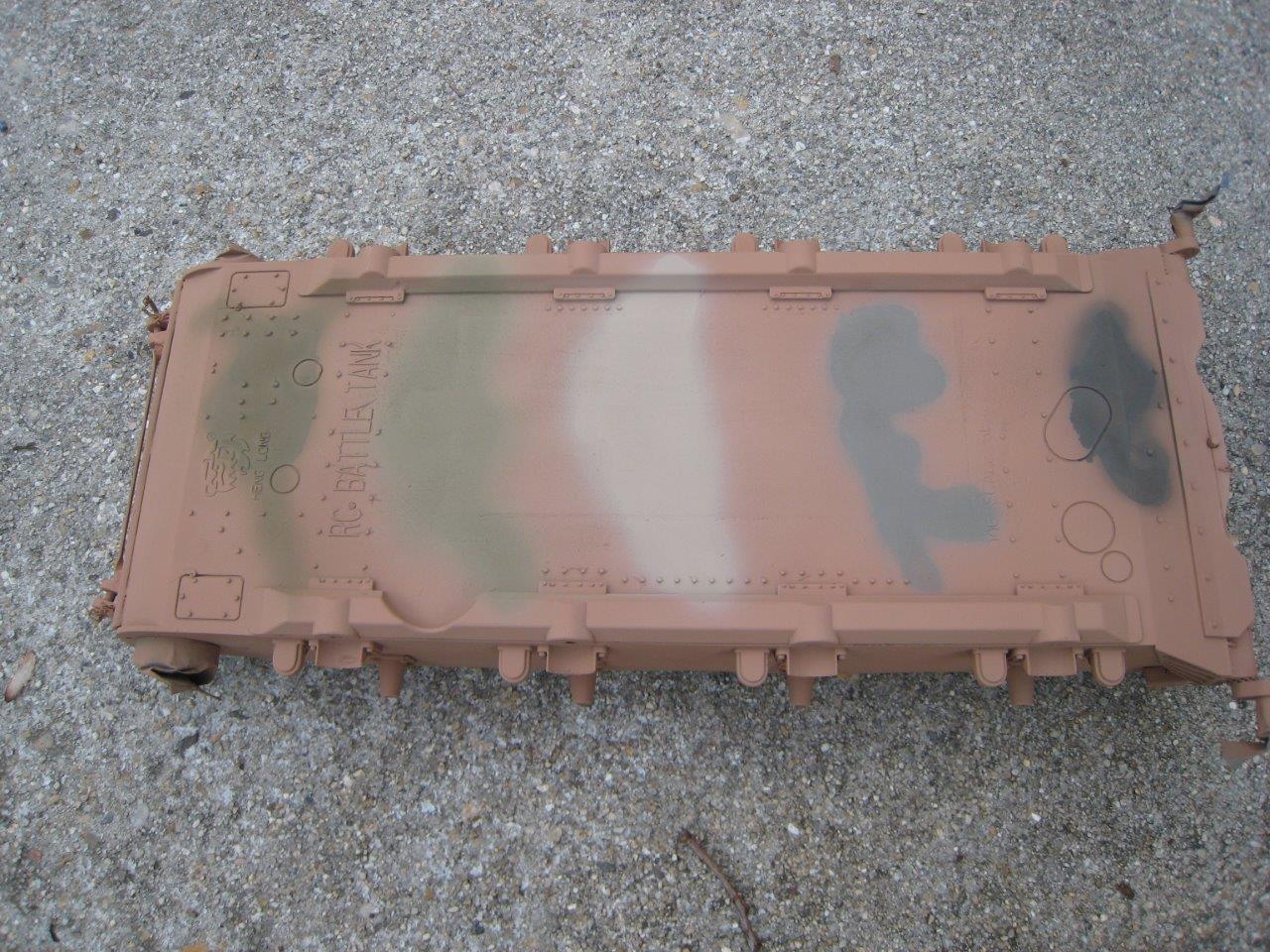

Internet research was going nowhere. So, I decided to just go with Tamiya’s recommendation exactly as it is. Here some photos of the base color. Some are in the mid-day sunlight from different angles and some are in the mid-afternoon shade.
This brown has a redder hue in the light and a browner hue in the shade or dim light. I’m liking it.

Playing with some mixtures for RAL 7027. There is some disagreement on the internet about the shade and hue for RAL 7027. I’m leaning towards the references that indicate some amount of green in the color. That would make it a grey-brown-green color. Given the lack of distinct camoflouge in the photos, most of which are black and white, it’s quite possible that the dust covered it, the shades were similar enough to disappear in B&W photos, or both. Probably both. Anyhow, did some experimenting with colors. Tamiya calls for straight Buff (XF-57). But, that lacks any green and is way to light in terms of contrast. So, I’ve played with adding Khaki (XF-49) and Khaki Drab (XF-51). Both of those are two green with too much contrast as pure colors. Mixing them Buff works better.
These were taken in mid-day sun (first two), evening shade (third), and under flourescent lighting (fourth photo).
I really like the Buff:Khaki mixture. I might play with a 2:1 mixture (Buff:Khaki). But, right now, I’d say the 1:1 is about there. Interesting what it does in a B&W photo.

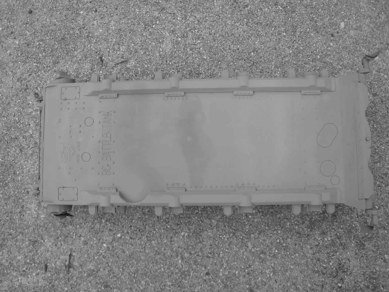

Still playing with some mixtures for RAL 7027...got some good ideas and now I’m torn between two mixtures. I really like the Buff:Khaki mix (1:1) and the Buff:Deck Tan:Khaki (1:1:2) mixes. The Buff:Khaki mix almost disappears in the B&W photos and the Buff:Deck Tan:Khaki completely disappears. Both seem to have a good green/brown/gray mix. Right now, I’m leaning towards the Buff:Deck Tan:Khaki mix. I’ll let it sit for a day or so and see which one grows on me.
Some photos in late afternoon shade, mid-day sun, and under fluorescent lights with their associated B&W photos (same order).

Personally, I like your first choice; I think the 1:1 Buff:Khaki mix comes up the best both in full colour and black-and-white. Trust your gut, though!
