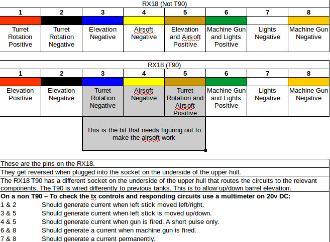

Okay, so I have installed the new HengLong RC board into my Tiger and all connections have been succesfully made EXCEPT for the main gun firing/BB shooting bit.
I have deduced that the very thin white and green (? I'm colour blind) cable is the one which control shooting or is the 8 pin loom wired up differently ?

I think I have figured out why the main gun isn't firing - the 8 pin loom is wired in the exact opposite of the original Taigen loom.

What you will find is that the 8 pin is reversed between the RX18 and the socket on the underside of the upper hull, no idea why HL do that as it makes things way more complex than they need to be.
The T90 8 pin works differently to its predecessors. The turret rotation used to be on pins 1 & 2, but the T90 has a different socket on the underside of the hull, this changes pins 1 & 2 to the elevation, which is how they get two way elevation on the T90, rather than the single cycle elevation on their other tanks.
It would be worth running all 8 wires through a block connector initially, so that you can swap them around until you have the correct configuration, or if you know how to do it, pop the pins out and swap those around instead. A multimeter will tell you which pins are live when the tx is operated.

If you have the T90 socket that goes on the underside of the upper hull, then its a straight swap. If you don't, then:
The end three wires 6-8, usually yellow, white, green, stay the same. That's the lights and machine gun.
The middle three 3-5, are the elevation and airsoft on the old Rx18.
The first two, which are normally black and red, are the turret rotation on the old Rx18.
Armed with this knowledge, you can wire the the first 5 pins on the T90 Rx18 to an old style Rx18 tank.
It should just be the first two, the rotation, that need swapping with the elevation wires.
The neatest way of swapping wires around is to use the back edge of a modeling knife and push the locking tab back in, then pull the wire out, ease the locking tab back out and push it into whichever slot you need to on the 8 pin plug.

This might help. I don't have airsoft, so can't test the circuits. Unfortunately I can't trace the circuits in my T90 as I rewired it to take a Clark Tk24 with IR. :|
