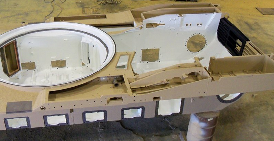

greengiant wrote:The only pic I found of it is hard to see but I think it is a straight line. found the pic at a site called Building the M1A2 Abrams where they have 36 pics of Abrams being rebuilt to A2 specs. In one pic with the turret off the area you want to know about is not a direct down shot but the most of the cutout can be seen on the left side of the pic and I thought it looked straight. the pic couldn't be downloaded so to see it you will have to find the site. Search, pics of the us abrams tank, and under the images that show up the first site under those was it when I was looking for the same thing.
Thanks GG,
Better pic than mine. Though not conclusive I think I see a very slight break (jog) in the line in question.
Thanks!
Barry

greengiant
Posts: 1138
Re: M1A1 HA, 10/15 update, NBC external fittings
Post by greengiant »
At first I to thought it was not a straight cut.
But after seeing how close the edge was to end of the v shape I decided it must be straight and the bend was caused by the camera angle of the picture . Purely speculation though.
Either way it cannot be seen when the turret is mounted so I guess its shape is still something to guess on. When I was looking I was hoping to see a pic of the hull of the Abrams that had had its turret blown off. There are several pics of a turrets blown off but none of the hull it came from that I could find.

greengiant
Posts: 1138
No trouble at all.
finally found pic your looking for on a site called building the hull of the M1A1 Abrams. Good overhead shot that clearly shows a slight dip in that grate opening.
