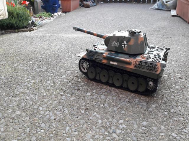

Ps I do have the Pantiger also,
just my luck I suppose to have 2 never wases :(
it has a very bad wobble on the front drive cog or what ever you call it the chunky one on the right
I have tried to get the silver cap off but I think this is not one of them that you can do that with :{

The cap will come off , just insert a tiny flat blade screwdriver under it or a stanley knife blade and wiggle it around the cap.
It will pop right off.

thank you I did get it off in the end but could not see where the wheel is going oval I can see it when the wheel is driving with the track on
so it looks like I will have to remove the track and then see what's what

It's possible the gearbox inside is loose , ie , the screws holding it down might have stripped the plastic or just come slightly loose.
Means splitting her apart to have a proper look though.
Perfect tank to practice these skills.
