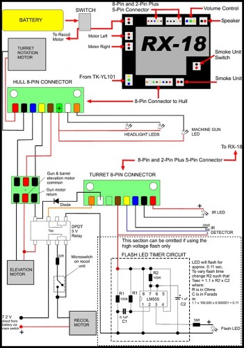

As Tracks suggested, if no power is getting from the battery to the RX-18 MFU suspect the switch. Try bypassing it with jumpers if you have any. Just a long shot..you haven't perhaps put the battery connector into the wrong socket, have you? Here's a diag to help- I hope:-

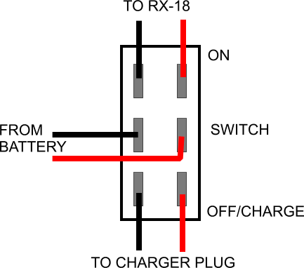

This is how the switch works (with charging point..I found it on an Aussie website 'havoc' something..or other):-
Charging switch.gif (8.86 KiB) Viewed 2488 times
