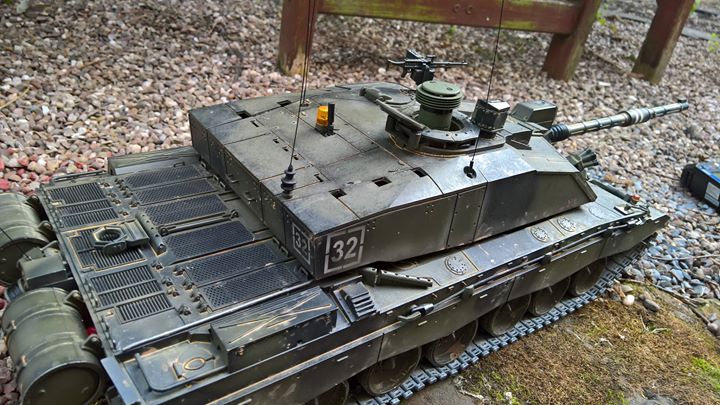

Love the choice of color

Hi sponge loving the chally looks amazing can I ask what colour green you are using I used nato green on mine but yours looks miles better and more realistic hopefully one day I will get there lol

Alright dude it's Tamiya olive drab, and the black is Tamiya nato black over sprayed with Tamiya matt black, am sure yours will look fine mate,be sure to get some more pictures on! Any more questions feel free to ask dude

hi mate thanks for that i used tamiya nato green and nato black. when you say you over sprayed with matt black do you mean the hole model? like a light coat all over.

No just over sprayed the nato black camo stripes with a cost of matt black with the airbrush, I did use matt black to highlight all the panel edges and flat earth to lightly over spray the whole model and more concentrated in certain areas where dust/ dirt would accumulate

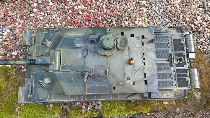

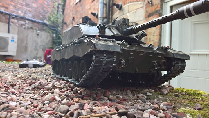

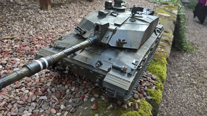

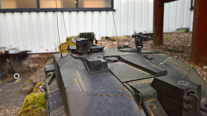

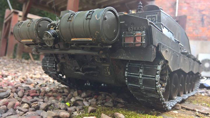

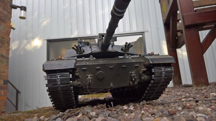

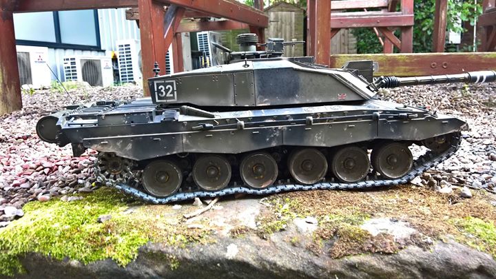

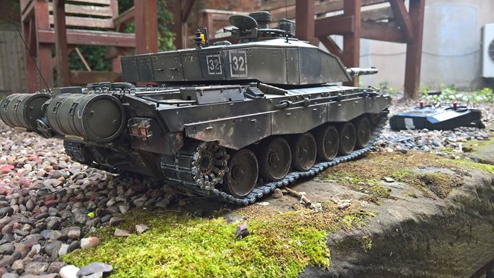

Well as promise finally finished! (ish)

I think this is my favorite Challenger that I have seen :thumbup: I'm a fan of the green and black camo. Well done mate :thumbup:

Cheers dude all she needs now is an economical idler adjuster as the only one i have seen is 200 odd quid! And I love the black and then camo :)
