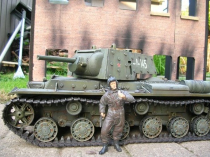

The acrylic floor polish is not the final coat. I use it after my basic painting is done to apply decals and it is also great to get capillary action when doing pin washes and some shading. But once that is done I actually use flat lacquer which you can find at RR hobby shops and do that as my final all over coat and then I add some final dusting.... Everybody has their own methods...
- KV1-1.jpg (84.89 KiB) Viewed 433 times
- Sherman-3.jpg (84.28 KiB) Viewed 433 times
