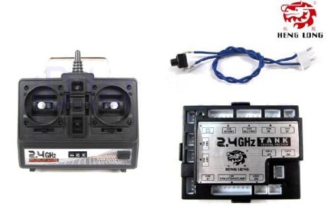

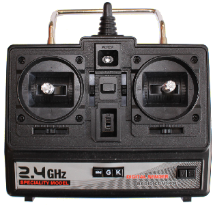

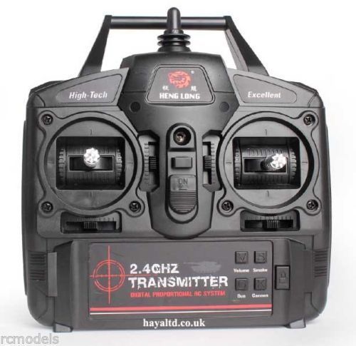

MichaelC
Posts: 2449
Location: Toronto, Canada
Re: Can I buy just the RX18 2.4ghz units Q
Post by MichaelC »
Royce,
My understanding is that there is 3 versions of the Heng Long 2/4Ghz radio and receiver, and they are NOT compatible with each other. If you are buying the receiver separately from the radio (i.e. for your other tanks), it is imperative that you know what version of the radio you have now to make sure you get a matching receiver. You will need the same binding button for all of them, and I am not too sure if you buy the receiver separately you will get it, but you can always remove it from your current 2.4Ghz tank and use it on the receiver when you need them.
Version 1
Heng Long 2.4Ghz Radio and MFU.jpg (22.34 KiB) Viewed 1207 times
Basically the same case as their old crystal version but has 2.4Ghz marking and crystal spot blanked out.
Version 2
Again, same case their old crystal ones, but the crystal spot now has Volume and Smoke button on it.
Version 3
Completely new case with extra buttons like volume and smoke.
I hope this helps.

Yes, that was extremely helpfully and intuitive; thank you! (I was wondering about the binding button too; I noticed it glued up inside my new Tiger II but wasn't sure exactly what it was at first. I never had to bind it w/ the controller, it just worked for me... or so I thought, I have since read that it can take only 2 secs inmost cases to bind together anyways, but I don't remember holding any buttons etc.) PS: I love how the 3rd vers says: Excellent and High Tech! LOL
