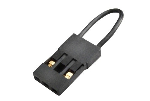

The other trick I used is to take a receiver binding plug, pop one of the leads from the end and slot it into the middle. I then put a colour heat shrink tube on the wires so I know it is a programming plug and not a bind plug anymore.

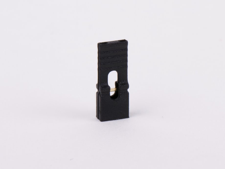

Mark, it is just any 2 pin jumpers like these:
Or these:
You must also has one of these to bind the receiver to the radio which you can then modded by pulling out one of the leads and inserting into the middle:
If you have never done it, you need to use a small flathead screw driver and lift the plastic tab up so it won't catch the lead when you pull it out.
