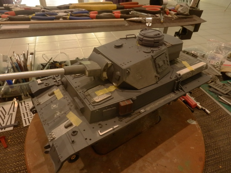

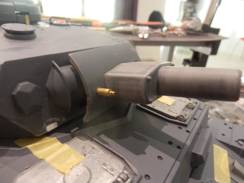

G'day gents, I've had a bit of a tune up done on my "casio-calculator" :haha: so I'm able to load pictures, for now anyway.
Been a bit of progress, but not as much as I would have liked.
All the hatches are secure, added a bit of guard damage, loaded the 2.4G brains into it and can now get on with it.
Seems like this one is stubborn.
MG added
MG added
Cross member mounted
hull securing cross member
Posts: 8321
Re: HERMANS 'GERMAN SHERMAN' PZIV F2 'B11'
Herman Have you thought about a bulkhead between the Gears and the Control board ?
Just a sized piece of plasticard and some plastic channel for the bulkhead to slide down.
A hole in the bulkhead large enough to take the cable from the motors to the board,
I use channel from a Panzer 4 radio stowage track, You only need a small piece glued onto each side of the hull, just enough to provide a guide for the bulkhead,
Glue the Channel DON'T Glue the Bulkhead.
This will stop the gearbox lube from ruining the electrics and the real thing would certainly display some external oil smears.
Shaun.
jarndice wrote:Herman Have you thought about a bulkhead between the Gears and the Control board ?
Shaun.
I did put a section in behind the gears, but it won't be enough to prevent all the spatter. Once it runs for a bit the bull will end up where it ends up, any extra lube will have to be sparing as possible.
