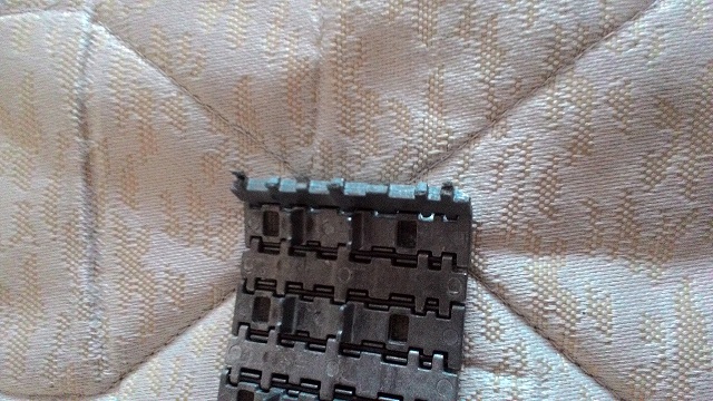

That's strange. Could you take some photos and tell us where you bought it?
NGKGTATT
Posts: 49
Joined: Mon Nov 02, 2015 9:21 am
Re: Broken King Tiger metal tracks
Post by NGKGTATT »
Rad_Schuhart wrote:That's strange. Could you take some photos and tell us where you bought it?
It came from china like this without any box

really looks like the tracks suffered from debris causing load up on the pins, that are not full-eye and only the ends of the pin is retained in each link.
Try the glue, then look for full eye tracks.
Check they are not to tight as well.
If so, any extra crap will over stress any weak point.
