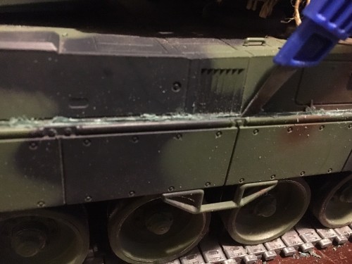

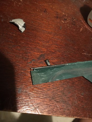

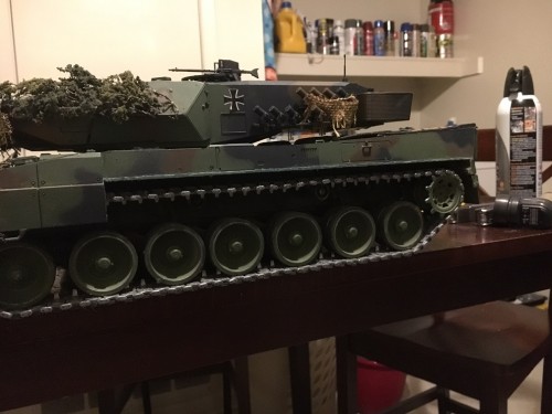

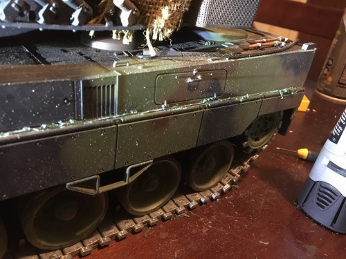

TheSynchronizer
Posts: 52
Joined: Mon Feb 29, 2016 5:02 am
Re: Leopard 2A6 Skirts
Post by TheSynchronizer »
progress so far, waiting on the hingepins to dry.
