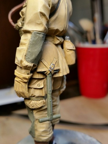

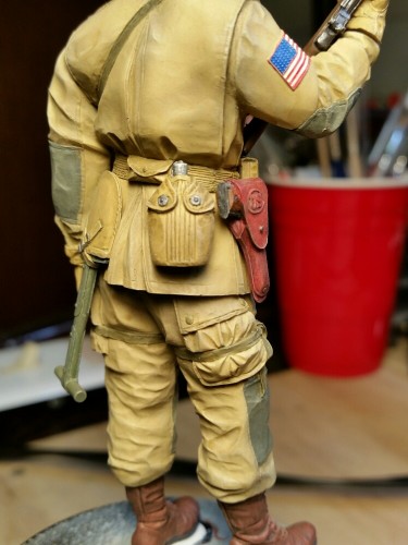

The elbow and knee pads were already molded onto the Alpine figure. These correctly represent the additional reinforcing that most paratroopers added to their M1942 jump jackets and pants. The padding in these areas were sewn on by the units’ riggers and sources of cloth tended to be quite different from the khaki-toned jump uniforms, hence the contrast. Similarly, some units had their own “rigger made” ammunition pouches made which differ from regular GI or Air Corps issue gear in both appearance and color. I used German WWII field gray as the base for these patches since it approximates US herringbone twill.

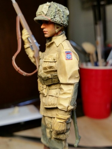

NB – Among the many flaws on my figure, I realized after shipping it to Tom that the ‘Airborne’ emblem on the top of the figure’s left shoulder is wrong. The top portion of the emblem should be a separate, blue rectangle with white lettering. I mistakenly have it with red edging. Only the separate 82nd Airborne square beneath the airborne patch should have red.

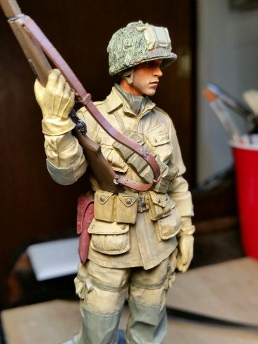

The rifle sling is very well detailed and matches era photographs. To get the right sag on it, I drilled a hole in the hand (which was molded onto the rifle) and at the end of the corresponding wrist. Then I glued a piece of styrene rod into the hole on the hand to act as a peg. This allowed me to position the hand and rifle on the mostly assembled figure to fit the sling but to still allow it to be removed for detail painting. Next, using CA glue, I fixed to top sling to the sling swivel on the rifle. With the figure tacked onto a sturdy base with a little CA on the feet, I positioned the rifle onto the figure and then used my wife’s hair dryer to gradually warm the sling until it became flexible. At this time, I used a pair of tweezers to gently position the sling until the base of it lined up with the heel swivel on the rifle. Then, allowing it to cool while holding it in place with the tweezers it will maintain the proper sag and can then be glued to the rifle with CA. This was all done before the figure was primed and painted. (The attached picture gives you an idea of some of what was done to facilitate this.)
To paint the sling, I used a base of saddle brown and picked out the metal parts with a mix of Model Air black and steel. I then gave it a wash of German WWII dark brown thinned with water and Vallejo Glaze. Later, an additional pin wash of this same mix helped to darken shadows and recesses. A light dry brush followed using a mix of saddle brown lightened with flat earth. The same approach was used for the Corcoran jump boots and Boyt holster for the M1911A1 pistol, only starting with slightly different shades of reddish brown for the leather. I dry brushed the boot laces a much lighter shade to make them stand out.
