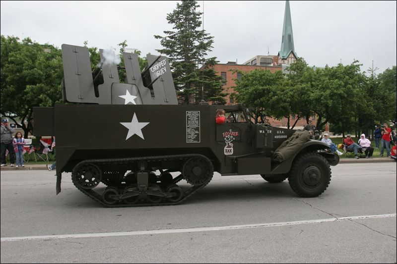

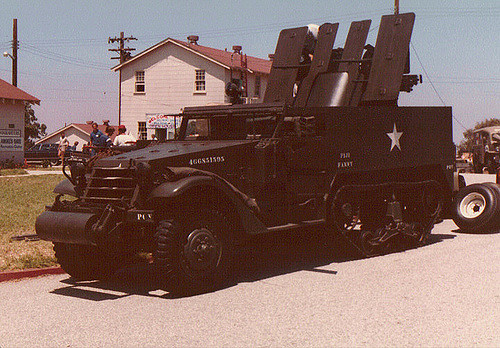

Might I suggest some type of armor plate attached to the "turret". Even some of the halftrack units added that to give some protection to the crew members as they reloaded the 50's.

TK, They did actually mount some quad 50's in the back of deuce and a halves during Vietnam with added armor almost the same as that pictured in the half tracks above mostly to be used as convoy security gun trucks.

Good ideas. I think I will see about beefing up the armor a bit. I also have another M-16 that might look good with the additional plates, as long as clearance doesn't become an issue. The fold down sides aren't functional.
GG, what halftrack is that in the photo? I don't think it's an M-16 because it doesn't have the fold down pieces on the sides, but i don't know much about halftrack variants, except to say that they were legion.
I also like the roller on the front of this one, and might convert the M-16 to something similar. I hear the Torro model is incorrect there anyway. Mine looks more like a winch.

Pretty sure its the straight M3 halftrack, with rear troop entry door because it was really built to haul personnel. But many had the quad unit added before the dedicated quad 50 M16 version was built to allow better anti personal firing capability with the lowering of the side and rear panels. The added armor was always cut back enough on its lower ends to clear the sides and rear and never extended down very much lower then the compartment sides and was, as can be seen in the pictures, mounted very close to the main tub of the mount with the gunners leg area sticking out through it.

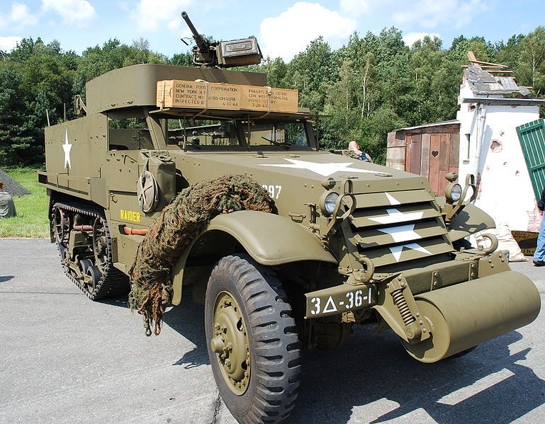

Not researched much by me but I think the roller was only used on the troop transport halftrack versions along with the rear troop door and cargo carrying racks on each side of the rear door and often mine carrying rails on the troop compartment sides.
I think there have been some builds of those types using quad 50 unit as a starting point but can't find any in our forums.
Did some research for you and found some pics of M3 restorations that are different but have the front roller and without the protected pulpit for the 50 cal that seems to have been added very quickly after we invaded Europe as were the winch bumpers. couldn't find any showing the back of the troop box with the door and storage racks.

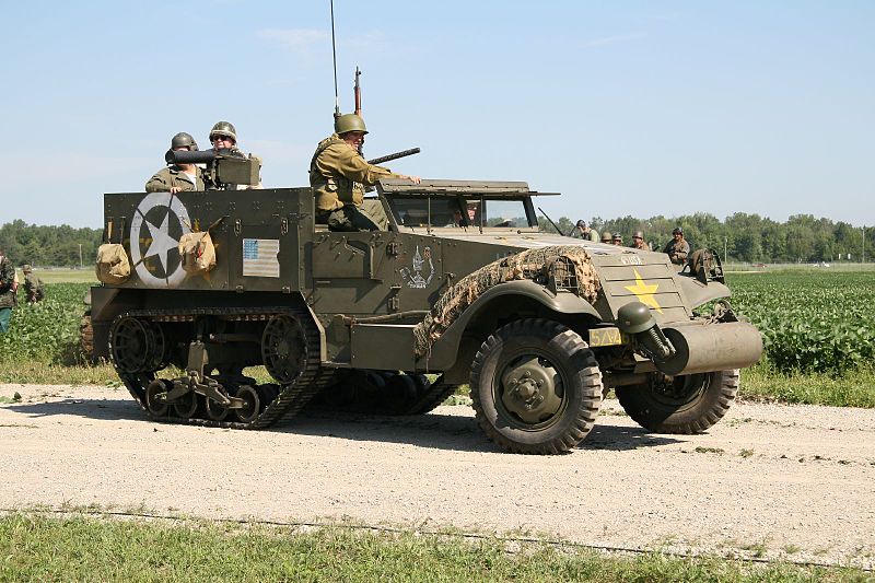

this one has the mine carrying racks on its sides and the 50 cal gunners pulpit
