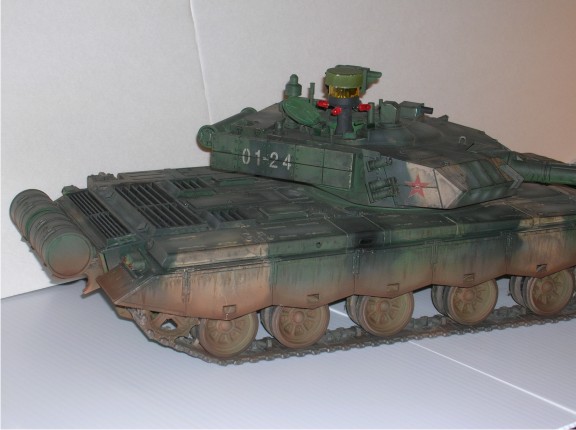

I've used it on custom made decals printed on Scopa and Bare Metal Foil decal paper (both inkjet and laser versions, clear and white). For the custom inkjet decals, these are kinda thick especially using the Scopa decal paper, as I give the decal a clear gloss AND a brush of Microscale decal fluid, hence the resulting thicker decal.
NONE of that is an issue using MicroSet and MicroSol. It makes these thick custom decals thin and adhere well. My only issue is that some custom decals tend to curl up and not adhering to the surface despite using MicroSet and MicroSol, but that is more to do with the water I use (not warm enough) and the initial prep work on making the decal. A simple solution was using diluted white glue to prevent or remedy curled decals, and judicious MicroSol to make it adhere.
Results are splendid, with custom made decals looking like they've been painted on. Examples:
