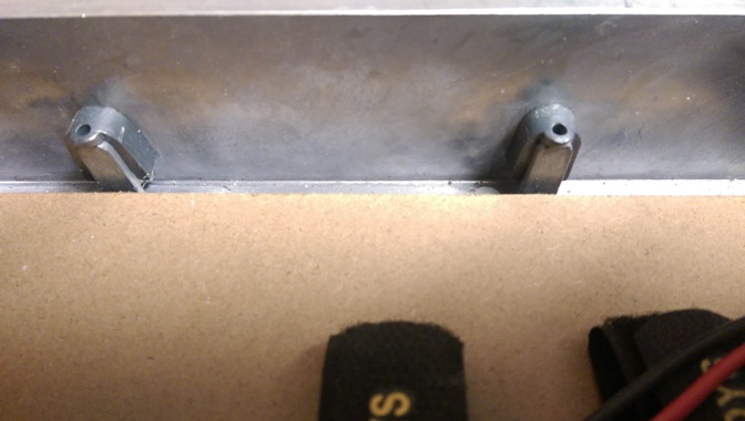

Thanks for the response Dave but the metal hull doesn't seem to have screws. It looks like this:
The clips that hold the bogies to the hull are attached very firmly and there is no obvious way to remove them that I can see.

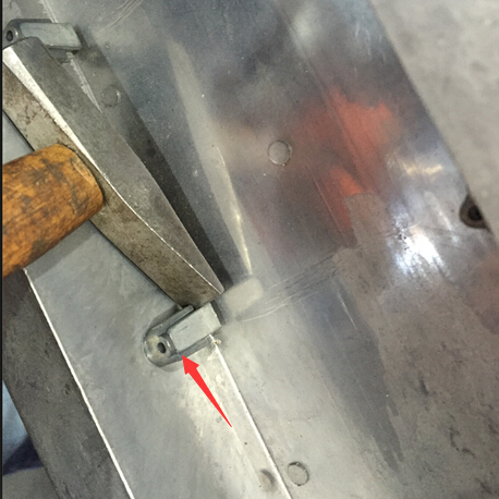

this is what mato sent back
Dear Dave,
Please find the attached picture for reference. You need to pry and take off the part which I point.
Any problem, please let me know

Thanks again Dave, you have been a great help.
