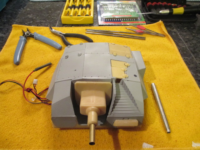

Sunday was BBQ day so I spent all afternoon in front of a hot grill and the evening cleaning up after Guests had left. Today was StuG day and I was determined to get the main gun mounted and working. After a walk the dogs session and a visit to the gym and breakfast, I got busy. It was immediately apparent that the barrel clamp and the elevation trunnion were still too long. I ended up removing material from both ends of the clamp and one side of the trunnion to give the gun barrel enough space to recoil freely. Elevation works but is minimal. It's an early Assault Gun graced with a honking great flanged mantlet so not terribly bothered by that. At least it works. The real heart breaker today came after I realized that if I drilled out all of the material required from the bore of the lovely little aluminum gun barrel for the flash to fit, the walls of the barrel would be almost paper thin. I sat the barrel aside after one drill session and cut a replacement in 1\4 inch brass tubing. I will have to add a muzzle crown with a small washer but at least there is room for the flash now. The mounts were made out of left over plastic from the original idler mounts and super glue gel and double stick tape. Weird but solid. I ended up padding the gun mounts 1/16 of an inch after that to get free play on the exterior. I was very glad that I had cut the steel pins for the mantlet a little long. It's all together and it works. Tomorrow or Wednesday, I will fix the barrel crown detail and glue the xenon flash into place. Pictures:

251 tracks in the Post yesterday! Thanks again, Jack! Last night was a mixed bag of results. I got the Xenon flash mounted and the wiring tucked away. Double checked all of the connections and gave it a try. Well, recoil and elevation still work fine and the red 'Firing Warning'\Emitter light comes on but I have no flash. The gun recoils, sounds right and the tank gives a sedate backwards recoil bump when I lift the stick. I think I may have damaged the bulb inside the cover when swapping it to the new barrel. Can't think of any other reason. I may buy another flash or I may use the red LED. *chuckles* I used a clear ring to give the replacement barrel some thickness at the muzzle so that turned out at least. I remounted the on\off switch ( yes, I checked that as well, nothing works on the main gun with it turned off ) and used some plasti card and brass to make a shelf to hide wiring and give the Commander figure a spot to rest. More tonight. Pics:

Nothing in the Post today. So tonight, I tried _unsuccessfully_ to bring the existing flash unit back to life. I was about to just use the red emitter bulb and call it a day when I discovered that I would have to make yet another new barrel. The old flash was 'secured' very well with the LocTite epoxy I had previously used and would not be removed. Choosing the better part of valor, I ordered a new xenon flash unit from Artistic Hobbies and cut and finished another brass barrel. There is plenty of detail work to do on the hatches while I wait for the new flash. At least this way, I will have the bright white flash I like on these tanks. Pics:
