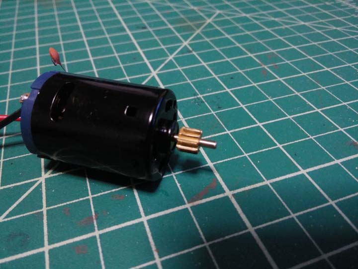

When all else fails...kick the darn thing :haha: :haha: ....just kidding spinwell....try comparing the old motors to the new...do the new ones have the diode?

3:1 or 4:1 gear boxes? Not sure but seems like you may have 4:1 motors (wired opposite to a 3:1, at the motor's terminals) in 3:1 boxes or vise-versa. Did you put pinions on the motors?, stock Taigen 4:1 motor's pinions are mounted close to the motors with some exposed shaft, 3:1 motors the pinion are at the end of the shaft.

Yes they do they look more or less the same apart the new ones are black and 380 motors which I just removed from some high low motors to fit to some mid low motors that fit the jagdpanther

I removed them from 4.1 motors and moved the pinion out to fit in 3.1 motors. Thought it would be just as straight forward as that obviously not

Thanks everyone got it all driving the right way had to swap the red and black wires round. 10 minute job and all great again
