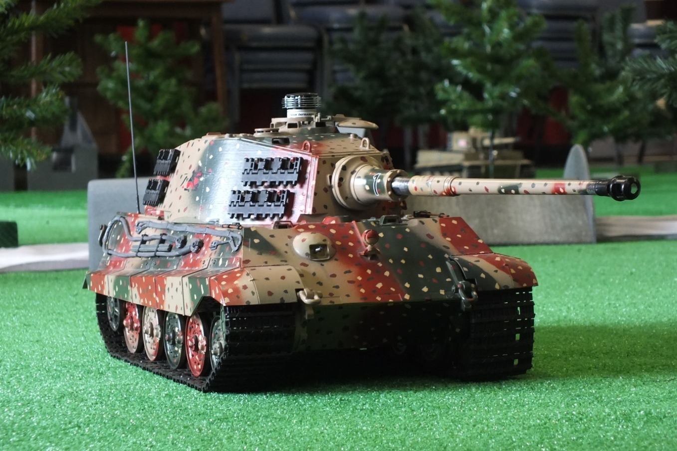

Hi mate I converted a static Tam KT into a Full IR battler one using HL boxes and turret gear with a servo recoil only hard part I found was the building of elevation mounts from scratch due to the turret being a empty shell.
The static sprockets will not match so you need a set of tracks and matching sprockets for your gear boxes, the rest came out of my scrap/spares boxes. Best of luck on your build
