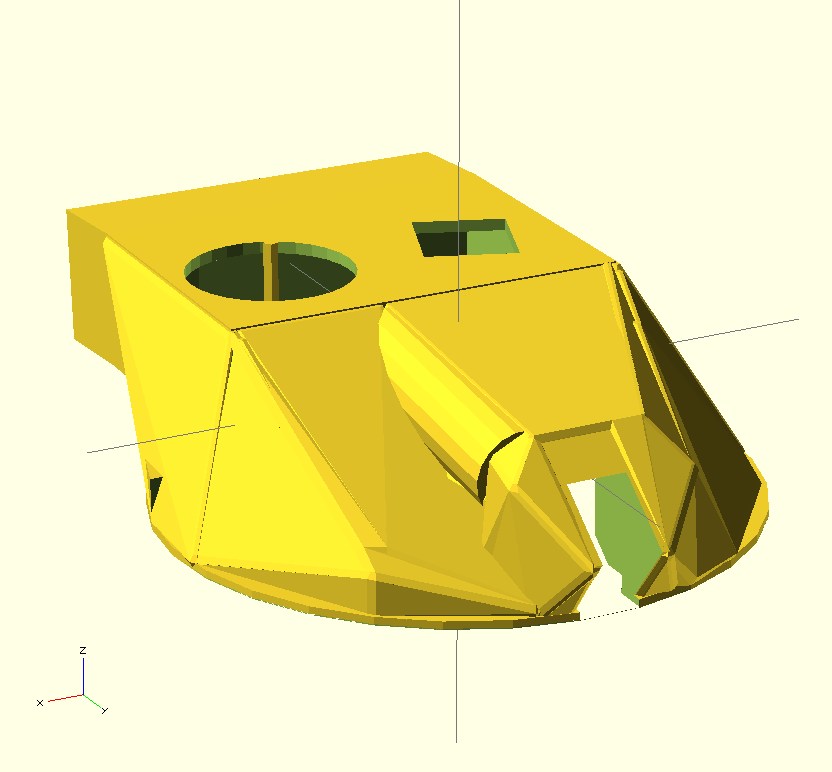

I initially set about trying to do the turret in Openscad so that I could 3D print it, but there was no way to get all of the curves correct doing it that way. So what I did was create a framework with triangles to get the basic shape, and then sculpt it with Milliput.
I bought the Tamiya 1/35 kit to copy, but when I printed and sculpted a 1/70 scale test version I compared it to photographs of the real one, and it didn't look right. A bit of research and I found that the kit is wrong on about 30 aspects. So a few mods to the 3D version and I printed it. It is huge, and I had to cut it in half to print it, each half took around 8-14 hours?

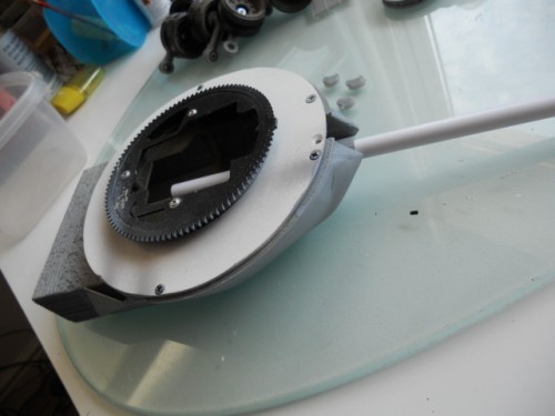

I then cut a turret base from styrene, screwed that onto the printed upper, and mounted a turret ring..it seems to have been a success. Just waiting for some more filler to arrive to finish the basic shape off.

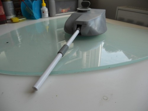

I printed a barrel pivot, and made the barrel from styrene tube, it's a loooong barrel. lol.
