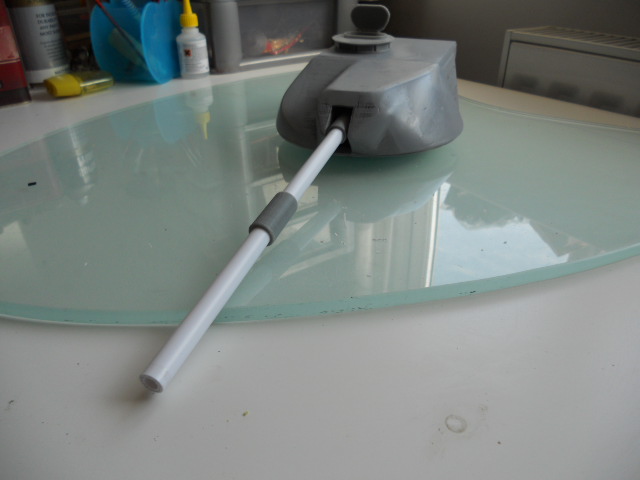

I held back on posting anything about this build as it is so complex that I had serious doubts about whether I could actually do it. The turret is a a bit of a nightmare, and I decided that if I could do that then the rest would be a walk in the park by comparison.
I initially set about trying to do the turret in Openscad so that I could 3D print it, but there was no way to get all of the curves correct doing it that way. So what I did was create a framework with triangles to get the basic shape, and then sculpt it with Milliput.
I bought the Tamiya 1/35 kit to copy, but when I printed and sculpted a 1/70 scale test version I compared it to photographs of the real one, and it didn't look right. A bit of research and I found that the kit is wrong on about 30 aspects. So a few mods to the 3D version and I printed it. It is huge, and I had to cut it in half to print it, each half took around 8-14 hours?

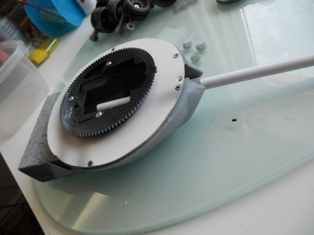

I then cut a turret base from styrene, screwed that onto the printed upper, and mounted a turret ring..it seems to have been a success. Just waiting for some more filler to arrive to finish the basic shape off.

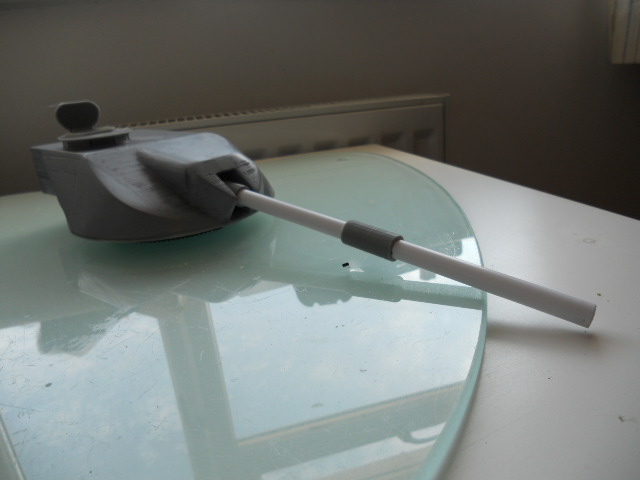

I printed a barrel pivot, and made the barrel from styrene tube, it's a loooong barrel. lol.

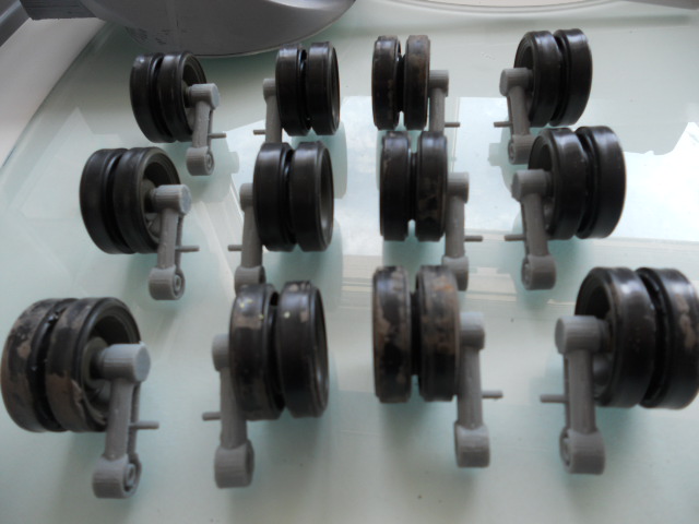

The Chieftain uses roadwheels that are a pretty close match to the Bulldog, so I printed 12 suspension arms that fit the KV1 hull mounts, but that have the correct diameter and offset to take the Bulldog wheels. Chieftain hub caps were printed to make the roadwheels more like the real ones. The road wheels should be in three pairs of two. It would be well nigh impossible to build accurate working Chieftain suspension as it is composed of multiple parts, and one pair of mounts is a different size to the rest, so I have stuck with the KV1 arrangement for reliability. I could in theory print dog leg suspension arms that would reposition the wheels into the correct spacing, and may return to this idea when everything else is complete (nice job for the winter...).

The Chieftain suspension is a very complex unit. To make the parts and have it all working smoothly would be several months work, there are a lot of parts to it. It would also have to be slim enough to mount the roadwheels and still keep the tracks aligned with the sprocket and idler, it would be a very tight squeeze, and would have to be very accurate.
None of it would be visible behind the side skirts, and unless it was all perfect it wouldn't work as well as the KV1 Heng Long set up. The easiest way is to do it the way that HL have done it, and know that I can run the tank without leaving a trail of parts behind it, or throw tracks every 5 minutes.
I can print the suspension arms in a different way to make the wheels into pairs if I decide to, no one would know as they wouldn't be visible.
Once I have the lower hull delivered I can see what the measurements will be, but at the moment I can't even begin to design them.
