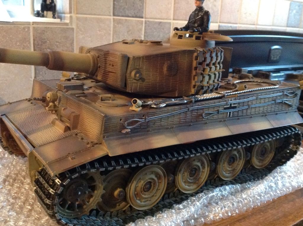

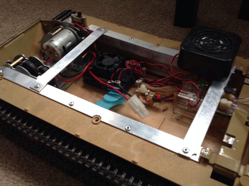

Hi all.....a few pics of my Taigen Tiger....had it a few days...fitted black steel gear boxes and some hull strengthening it's a full metal upgrade with metal wheels, turret, barrel, tracks and a few more little bits.....weighs a tad over 7KG. It did have the white metal gearboxes, but I kinda thought they would go at some stage....so replaced them with good old steel ones. It has the torsion bar /metal chassis.

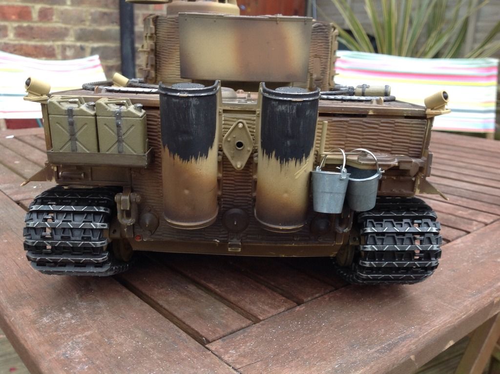

Ha Ha Tanks Kaiser....it's a great forum with people more than willing to share and help.....and I've appreciated it. I did see about the Hull smoke launchers on another post.....so I've removed them lol. The Gerry cans have been changed also as I wasn't happy with the way they were fitted. I must say I'm very impressed with the Taigen Tiger....although I'm sure the painting is not historically correct along with parts of the tank......but I luv the way it looks and drives. The 4.1 black steel gear boxes have made a difference and it now turns on a penny on the Lawn no problem.....the white metal ones that came with the tank did strip out........ Any advice guys please let me know

The camo job doesn't look too bad some weathering would really bring it out better. But the paint work on the exhaust shields aren't very good you'll want to redo them before doing the weathering. But all in all its not a bad looking tank and I know its a great runner as its basicly like 2 of mine.

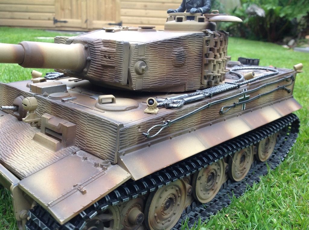

Cheers guys......totally agree with the rear exhaust shields......I'm a bit worried on doing the parting of fenders as I don't won't to balls it up.....how do I start lol

Mark Hi. to seperate the side fenders you will need "A ROLL OF DUCT/DUCK TAPE and an EXACTO MICRO SAW"
Tape down each side of the fender join lines so that there is only a micro saw blades width free between them,
You are only trying to show that the fenders are seperate you are NOT trying to saw them off!!!
Then saw up to the side of the Tank body along those lines, REMEMBER! DUCT/DUCK TAPE NOT MASKING TAPE.
When cutting/sawing /filing or any other abrading on the Tank you should cover the surrounding area with this tape it will save an awful lot of bad language! shaun

I've used a razor saw to separate the side skirts because of how thin the saw blade is and you can go slowly as to not cut where you don't want. I'm good with a dremel tool but no way I'd use one to cut them apart.
