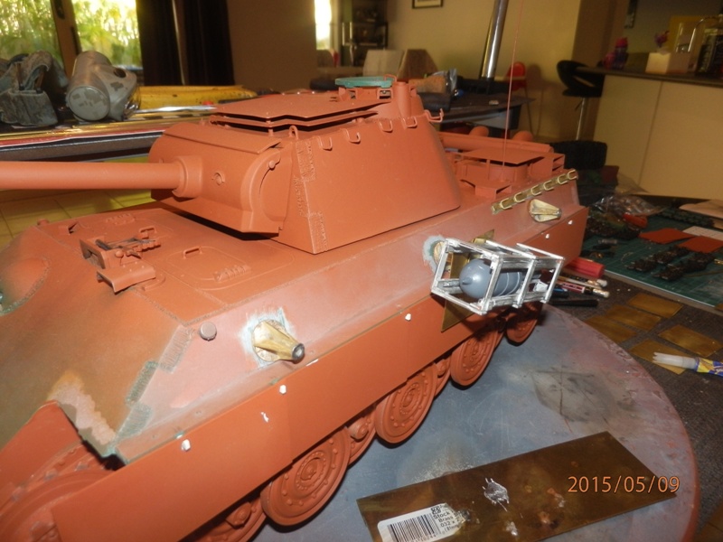

Been looking at him sitting there since I got back. How to make the rocket mounts easily removable, yet robust enough to stay on during use.
The Schurzen is a pain to fit if the rocket assemblies are permanantly fixed, not to mention any track issues etc that may occur down the line.
Ive done one rocket to test a theory & see how it looks.

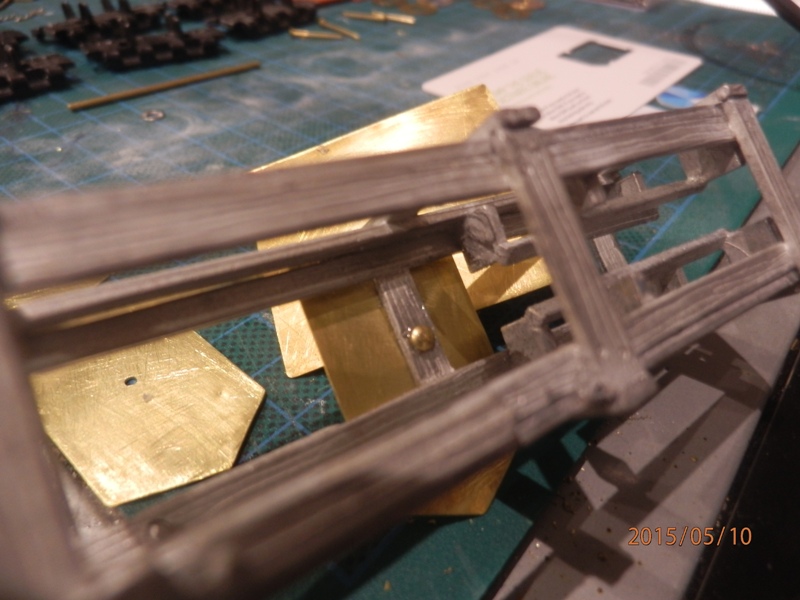

Used a brass picture hanging pin as the 'axle' through a tube which is soldered to the backing plate(that touches the mystery mount)which will allow the basket to fit freely into the mount as required.
I think I will drill a 0.7mm hole through the entire 'axle' system on the diagonal into each mount & secure the lot with a paper clip pin similar to those that will hold the spare track links on the hull sides.
Now I know this is not the method used in real life, but for this exercise it will be simple & effective to allow ease of removal.
Should this prove to be less effective, then I only have a tiny hole to fill & then glue the rocket assemblies in place.
The Schurzen can be fitted & removed with the baskets mounted, its just real bloody hard !
The assemblies would also suffer from handling during battery changes I reckon.
Anyhoo, heres one loosely fitted.

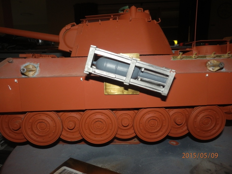

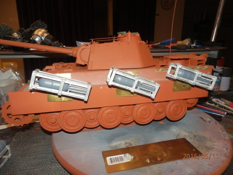

Managed to mock-mount one side of the compliment of rockets.
Still need to replicate the crate support members that actually would have bourne the weight of the laden crates on to the swivels, but as for position, this is close enough.
I feel that the placing of the system as posed in the 1/35th drawings on an 'A' model Panther as was the Littlefield machine with its mounts could have been a bit low for general use even when mobilising over relatively short distances. By default in keeping the schurzen mounting system as per the 'G', the mystery mounts have to be higher on the hull sides..................
Just seems more righterer !!! :eh:
This thing could have worked ;)
I'm a ways off yet from finishing, but the concept is taking on more of a realistic context over just a romantic theory :thumbup:
If a little bird had whispered in my ear a bit earlier than he did, these things might even have swiveled under power from the inside !! :shh:
