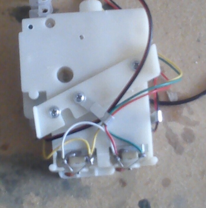

Ed picture of my unit wires at motor ..
time that's all it takes ,, TIGER 1,TIGER 2, PANTHER G, PANZER 4,KV1,T34,M3,M16,M4,M26,,251,CHAL

hi rayzzer ,my wireing is the same red &green from the elevation motor yellow from the recoil motor yellow connected in from recoil motor to micro switch with black wire from micro switch to negative battery I have removed the blue wire & connected white wire between recoil & elevation motors so wireing is same as in photo, I have connected red yellow &green wires to a three pin to plug in to hull top, now I have constant elevation but no recoil , iff I disconnect the green constant elevation stops but still no recoil [ 8 pin contacts are sound]

hi rayzzer, with your help & that of KTrob & MichaelC I have it figured out now, the problem turned out to be with the red & yellow wires in the three pin plug, they needed to swap places the[ correct way ,red to pin 4, yellow to pin 5, green to pin 6,] instead of the wrong way [ red to pin5, yellow to pin 4, ] tanker 242.
