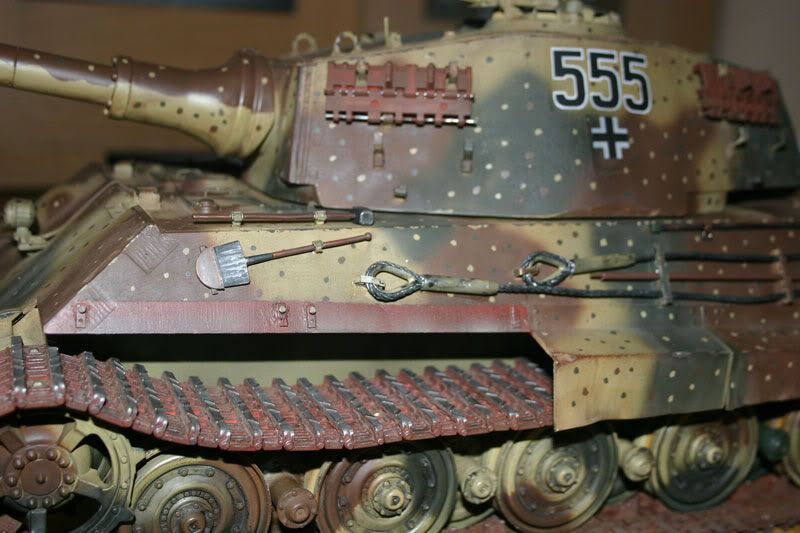

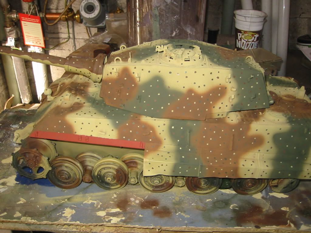

Everyone has different methods and colours they like to use with me it depends on the tank the colour of the tank and what effect I am after so the rules are flexible but use a different kind of wash to the paint you used to paint the tank or the wash could take the paint off unless you want this effect and we are back to the flexible rules. With the KT I am doing the now the pictures you will see before and after have been done with first of all I used a Matt varnish mixed with a little matt black to dull the paint down. I then used a wash with 90% thinner to 10% matt dark brown and brushed it on with a large soft brush make sure the paint stroks go the way water would flow off the tank. On the sides use verticle brushing let it dry then if you want give it another coat like I did with this tank an as Gunshy says you can then take some off with cotton swabs etc hope this helps.

Great Tips guys and what a difference the wash makes to your KT Stevie.
