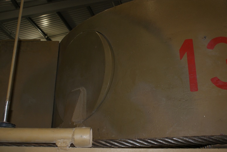

Details of the "box"
Again I have only with with HLs and the side exit hatch on the turret is usually skinny at the top and the bottom and I never figured out right. In reality it is actually try to simulate the fact that the opening of the hatch is not even with the turret opening so the middle part of it is exposed more than the ends.

The flat side hatch was bevelled at the sides, to blend in better with the curved turret, as you can see in the photo. But this was true only for turrets with the drum cupola. All turrets with the improved cupola had a simple flat circular hatch.
