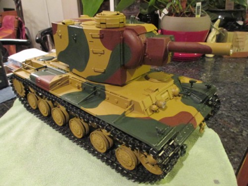

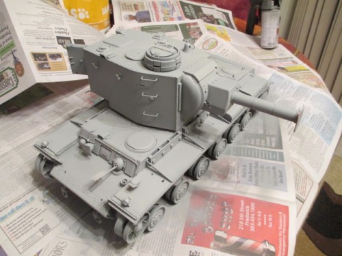

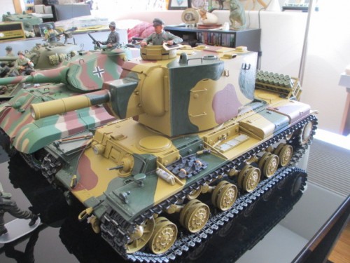

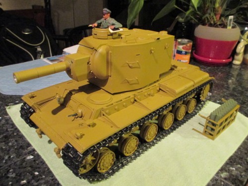

Should you prime? Yes. Tamiya makes an excellent plastic and metal primer that I use and it gives great results with no definition lost. Having said that, many on the Board here swear by Halford's red automotive primer, very nice if you are doing German armor and are looking for a realistic undercoat to do chip weathering with. Others will use a black primer and very light coats of the main color to get pre done shadowing effects. As for the add on parts, I paint tools and stowage after the main paint job is complete so they compliment the color. Anything that is permanently mounted to the tank should be painted while attached. Those pieces can be detailed with a brush after the paint and camo is applied. ( i.e., padding on the insides of hatches, etc. ) A good camo pattern is possible with a brush, it is called 'Hard Line' and is very cool looking when done right. No over lap of colors is possible using a brush, you just wind up with a weird third color or ridges in your finish. You will want to apply your primary color with an airgun or in your case, canned spray paint. Here is a basic set of photos as an example. The complete process involves a lot more detail and can be found in the build thread for this tank: viewtopic.php?f=23&t=12930 Good luck and take pictures so that we can follow your progress.
