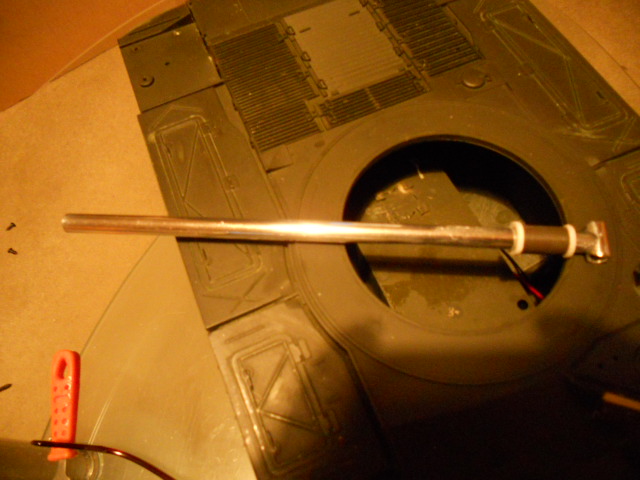

The suspension units had a lot of play in them, so I added two washers behind each one. It has solved that problem but the road wheels still have play in them, and that isn't an easy fix on one of these.
I made a cable reel to mount on the side of the turret, the cable is dental floss??
The Tank Modelbrau scale barrel is not cheap, so I thought, what have I got to lose, I may as well try making one using the inner barrel. Shaping the alloy tube and drilling it was a bit of a nightmare, the bore evacuator is made from a small section of barrel, with two styrene 'O' rings at each end. It cost nothing to make, and if it falls apart I will go and buy one, I am not doing all that again! :silent:

The new barrel got tapped and fell apart, so I am off to buy some metal bonding putty to see if that will fix it.... :eh:

The metal bond worked, solid as a rock now. The airsoft tube cleaned up nicely too. :angel:
