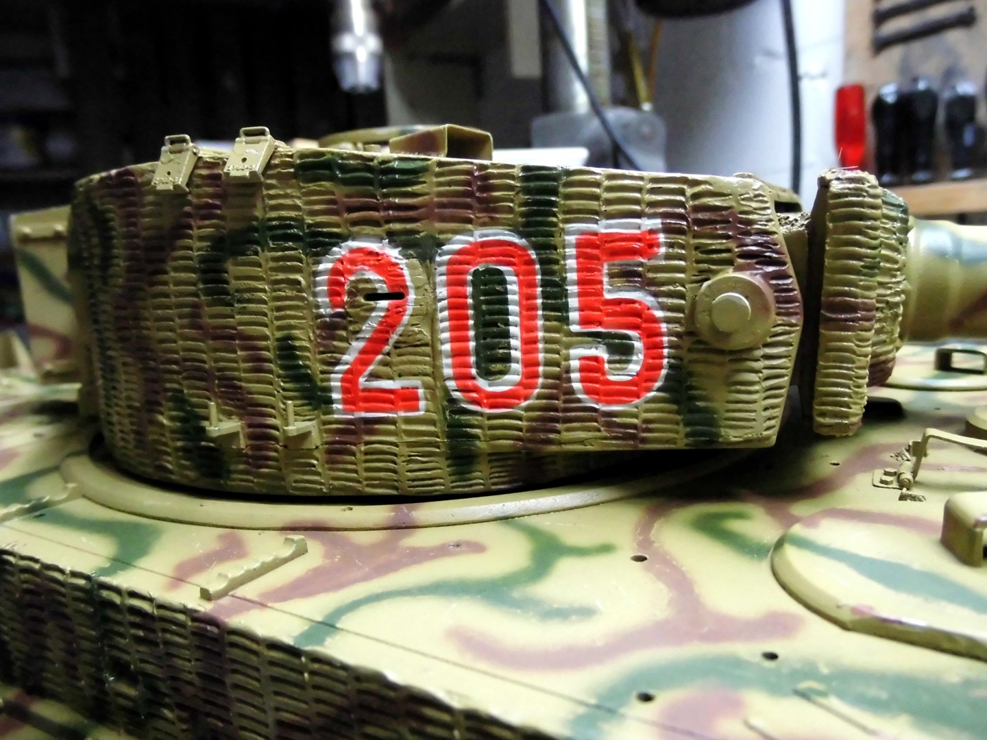

hotte8487 wrote:the trick is: take no decals at zimmerit surfaces
But i tried painting the numbers and it looked like a monkey did it.

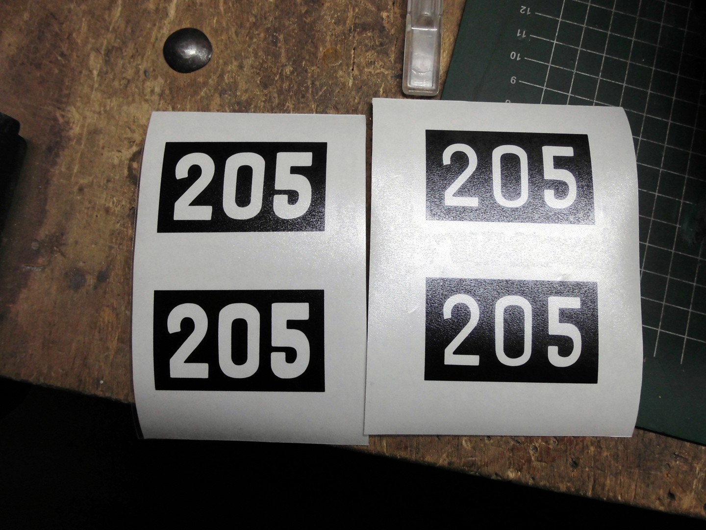

Using a softener is the normal way to apply decals on difficult surfaces. But a zimmerit surface is not only a bit uneven, a zimmerit surface has valued a double so long surface. This means the decal must become through the softener double the length. This is impossible (for me).
Look at Michaels decal, there is it good to see what I mean.
I've used stencils and my airbrush, shortly described in my report about my Tiger 1, it's not perfect, but for me even better than decals.
But everybody makes his own experiences.

Here additionally still two pictures.
I've used such self made and self-adhesive stencils. The first stencil still remains at the surface, after drying glue the second stencil exactly over the first and brush again.
Greeting Hotte
