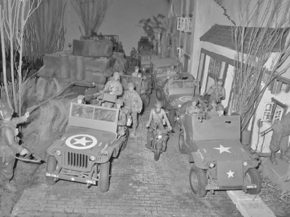

For black and white fans this was my alternative starting shot.
