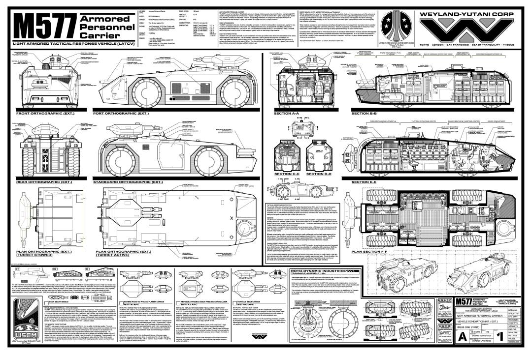

Has any one come a cross any line drawing of the APC used in the Ailens film ?
I had a google ...and all i can find is pictures ...but non that can help me scrath build ....i would like to build in 1/16 ....that my scale as i usual build armour and want a busmans holiday ..
Can any one point me in the right direction ? ..

Here ya go Mcevoyi

It's fortunate you are a great scratchbuilder...there is actually a lot more info about the Apc than you might think... found a couple more blueprints when I did my search... but they weren't as clear as the one I presented...blown up the images might be more helpful

JUST PERFECT .......i wish redhill was not so far away ..i'd love to pop along and have a bloody good look at it ......thats just what i want !
