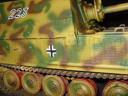

quick way to do zimmerit, I made it for the zimmerit on my elefant. It's the brass gear cog from a Heng Long motor.

oooh, great tip jrc :thumbup:
will be nicking that one! :haha:
