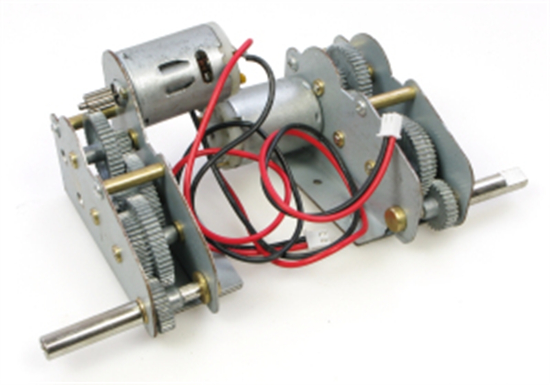

Rip out the stock HL Leo gear/motor set and was wondering if anyone know whether I can use it on a HL Jadgpanther.
Re: Would a stock Leo gearset fit into jagdpanther
Doesn't look like you can Micheal... the gearbox cages are different... the LEOPARD uses high profile cages...MichaelC wrote:Rip out the stock HL Leo gear/motor set and was wondering if anyone know whether I can use it on a HL Jadgpanther.
and the JAGDPANTHER has low profile
...I think the axle lengths are the same though... so your alternative ... especially if the LEOPARD set is metal... is to pull both... strip the cages and exchange the gears and bushings
GOOD LUCK
