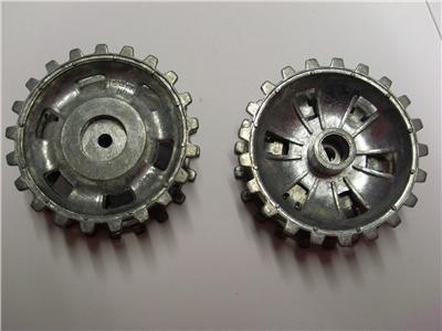

I recently acquired some metal sprockets for my PANZER III....Thought cool they might be better than the metal HLs ...but after installing one... ran into problems with the second...the first issue was there was a good amount of slag (from molding) around the three pins that align the two halves of the sprockets ...thought ok ..that's nothing big... and worked out the slag with some pin files and over drilling the holes on the opposite side...It was then I found the major flaw with these sprockets.... there was nothing to secure the two ...the inner sprocket bolts on fine... but the outer is hollow

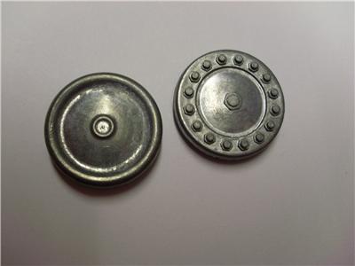

Anyway.. I stared at the three piece component... and solved the problem ....I drilled the axle bolt cover... by pushing it into position on the outer sprocket.. I could drill it with confidence that the hole would be centered ...by sending the drill bit through the back side of the sprocket...then ... I counter sunk the hole on the outside of the cover.... using longer screws...I was able to secure and lock the sprockets to the drive axles ...so no problems down the road (no pun intended)
Subsequently ... I found the other wheel went on easily because the pins weren't aligned... and found the slag problem to be the same...redid that side as well
these are the culprits
and the covers I had to drill
