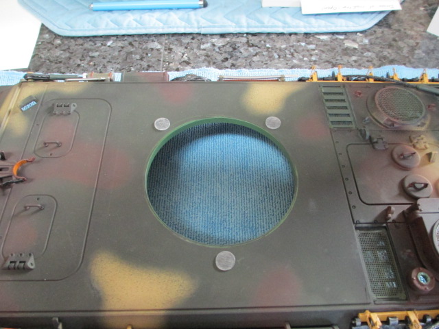

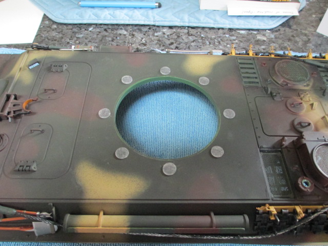

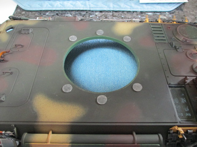

I use self-adhesive plastic dot 'Glides' available in Hardware stores. The are super smooth on top and the turret will actually glide to a halt like it is on bearings. They raise the turret just a hair yet the gear still engages solidly and also aid with clearance. Here are a couple of pics of them on my last build.

PainlessWolf wrote:Good Evening,
