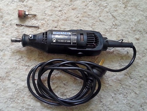

Hi S_B_72 i have just done a few upgrades to my Tiger 1 including cutting out the hatches and putting in metal ones .What i did was using my Dremel. if you haven't got one a normal drill will do,drill a complete circle of holes as close to each other as possible all around the hatches make sure you drill smaller then the hatch then tilt the drill at and angle using it as a saw and cut the remaining material between all the holes. After that get a half round file or even better if you have a small sanding disk attachment run all around the cut out section until you get the finish you want... Cheers Diesel
