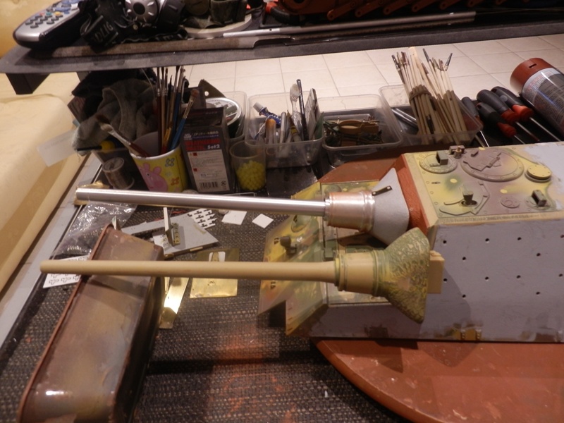

jackalope wrote:That thing looks HUGE! (I know, I know...THAT'S WHAT SHE SAID!......LOL!) Makes me wonder if the Torro barrel length is correct. How long is that barrel Herman?
Its 245mm from the barrel sleeve to the muzzle.
I have no reason to second guess the guys at Tank Modellbau on the correct dimensions.
Could be it looks bigger just because my Matorro hull is not the right shape, but it is very big.
It is about 1 1/2 inches longer than the resin barrel on the Matorro.

I've seen the Bovington Jagdtiger, and the cannon is so big it's absurd. It's basically a bunker on tracks, and yours looks just like it.

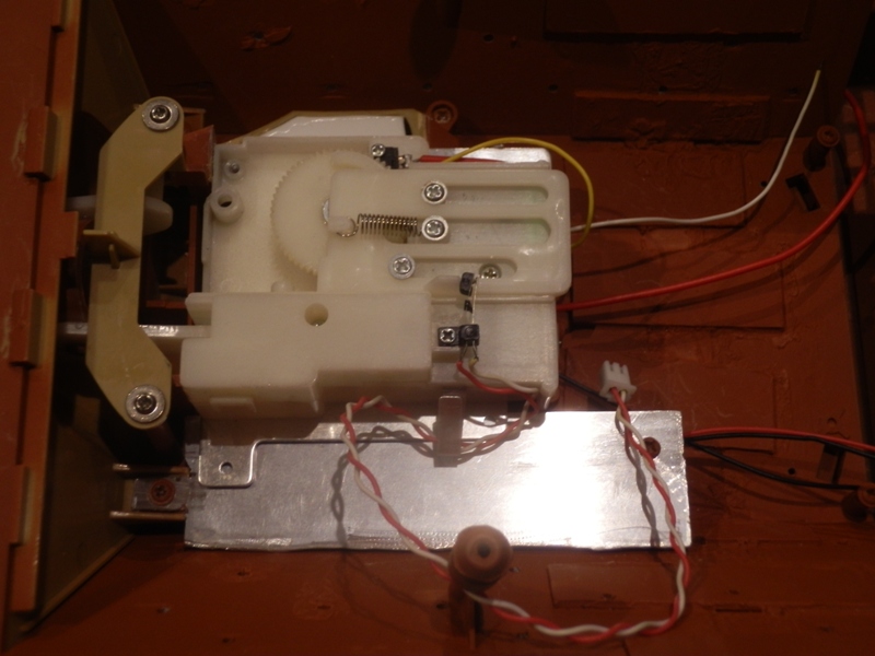

Well lads, after a long road of guessing, deciding, and pondering methodology & universal oscillation about the periphery , I finally figured out how to secure the Taigen recoil/elevation unit and get it to align with all the planets AND the barrel centre line. :crazy: :crazy:

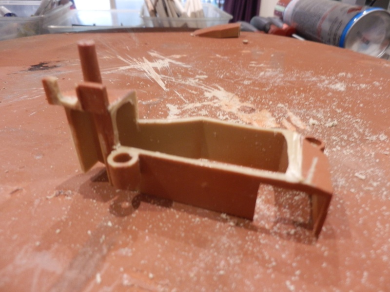

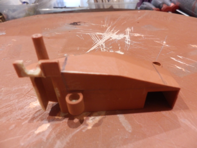

Had to cut the now redundant BB loading chute, and pick up an existing mounting point, then use an aloominum( :/ ) section to bridge from a redundant elevation mounting point in the rear of the casemate to one of the front plate anchor points.
Out of four mounting points for the Taigen unit, I can pick up 3 of them now.
I'm sure it's not all over yet as far as adjusting travel & all the rest of it, but from an empty casemate, to a shot at the title, I'm pretty stoked ;) 8)
The Taigen unit does not offer a lot of travel in depression, but for this thing with its 'Proboscis - Maximus' a little bit of down shows a lot . Plus the mounting is not perfect, so this is all round a good compromise.................

BB chute now !
BB chute now !
BB chute then
BB chute then
