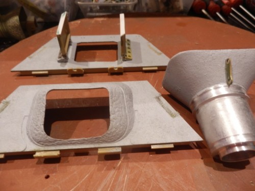

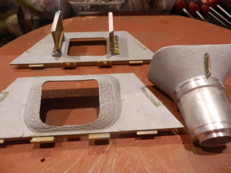

Tonight was only texturing the mantlet, front upper plate, and rear plate with Tamiya putty & thinners on the end of a good brush.
Made the hooks for the rear deck so when the bits I have on the way as swapsees arrive for the engine hatch, I can sort that & then place the engine deck details.

The surface of the cast pieces looks great.
Re: MATORRO JAGDTIGER CONVERSION
Shaping up real good. As said , that 'casting' looks wicked good .

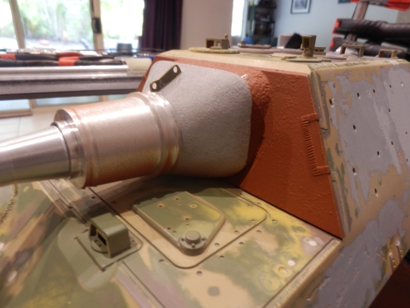

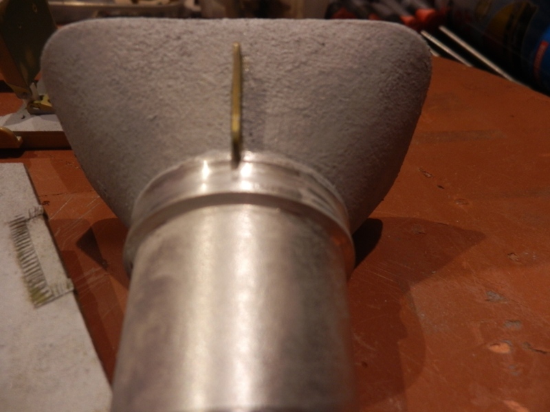

Casting was done with Tamiya putty & thinners stippled on with a stiff brush.

Thanks mate, it turned out pretty well.Soeren wrote:The surface of the cast pieces looks great.

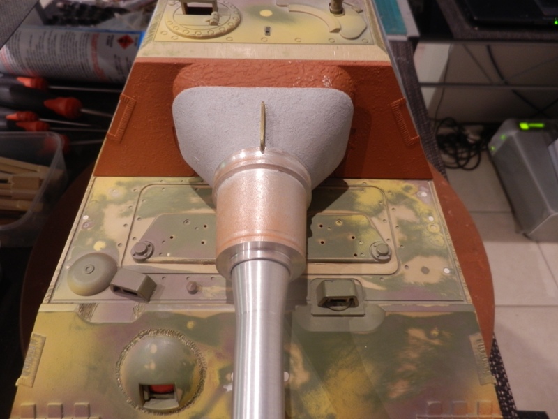

This kind of makes the effort worth it.

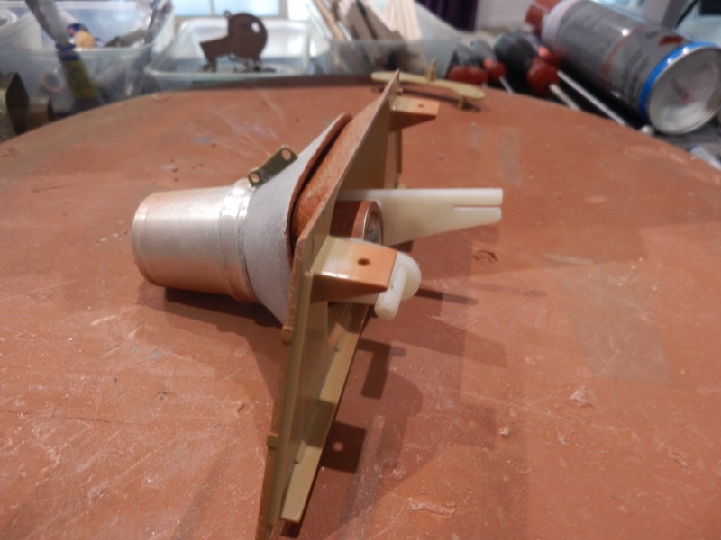

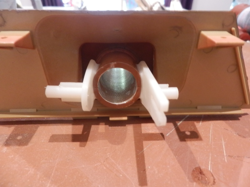

Primed the mantlet plate and recoil assembly.
Assembled using a good dose of PVA glue to assist the side plates onto the barrel sleeve.
As the pivots will not pass through the front plate, they have to be secured with the plate loose, then the lot gets placed in situ on the casemate.
Had to cut a 2mm allen key down to just a slight bit longer than the corner in order to fit the thing in the tiny gap to tighten the pivot plates, but got it.
A bit of added clearance to the pivot mounts in the hull and its in

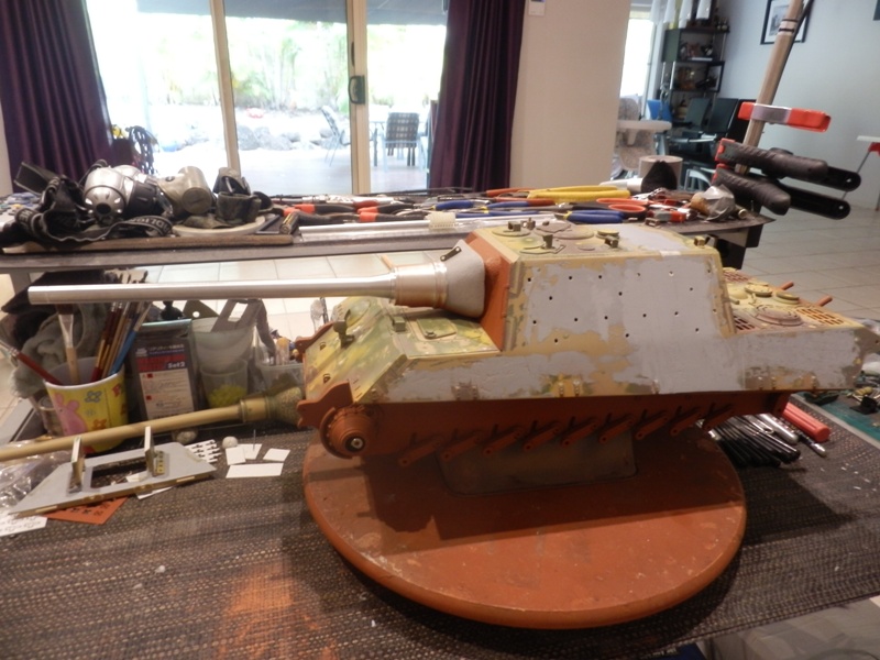

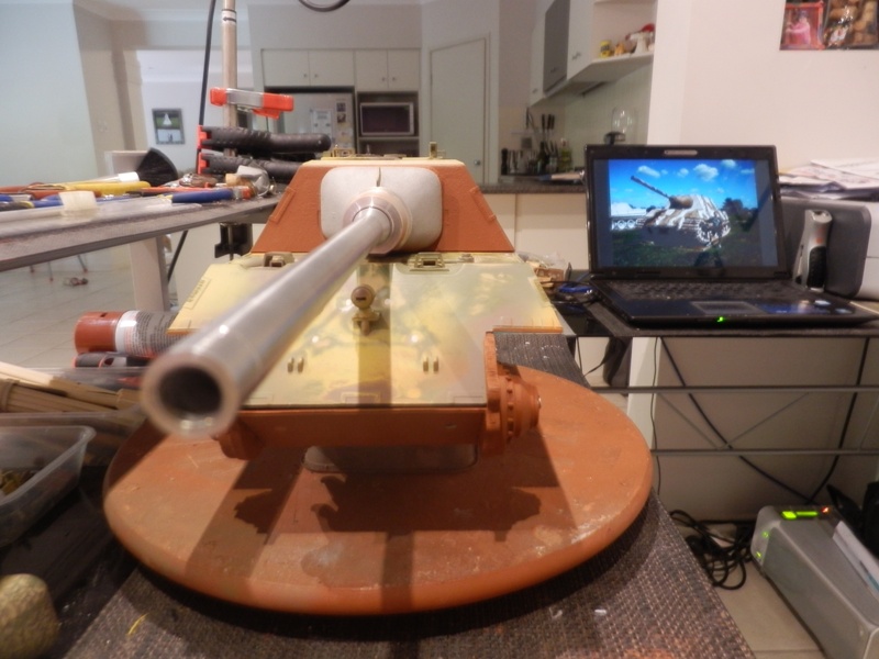

Barrel is outrageously big!!......................and I love it
Even managed to catch the screen saver picture I took when I visited APG in 2010 !!
That thing looks HUGE! (I know, I know...THAT'S WHAT SHE SAID!......LOL!) Makes me wonder if the Torro barrel length is correct. How long is that barrel Herman?
