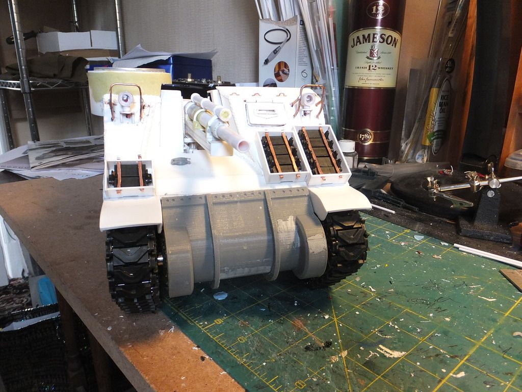

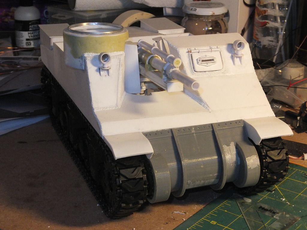

Drivers hatch and front lights done, hull welds done on the front but still plenty to do on the back. I think the welds look a bit heavy, but some of the photos of actual M7s show fairly heavy welds too so I'll leave them for now, I may revisit them later.
I'm waiting for white leds to arrive and then I can get the lights wired up. Lots of work to do on the gun but it's coming along.
  Alwyn

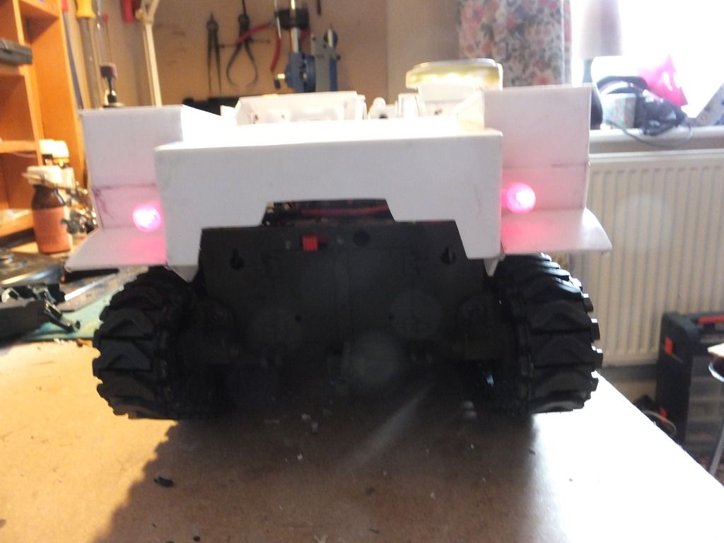

Finished wiring the front and rear lights but still can't find any white lcds that work at 1.3v, so had to settle for yellow. The spare track racks are on and the first of the fuel filler caps.
I'm really fed up as I tried to fire up the rx18 and for some reason it's not starting up, so now I have to try and fix that. It was all working fine before I left for hols so I really am confused, the lights flash but no action on the start button. Tried a different tx, a different rx, now I'll have to try changing the rx18!
  Alwyn
