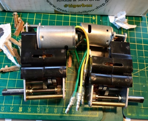

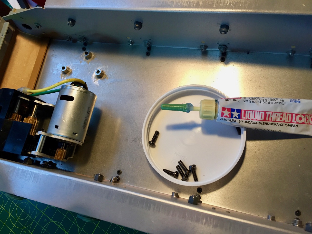

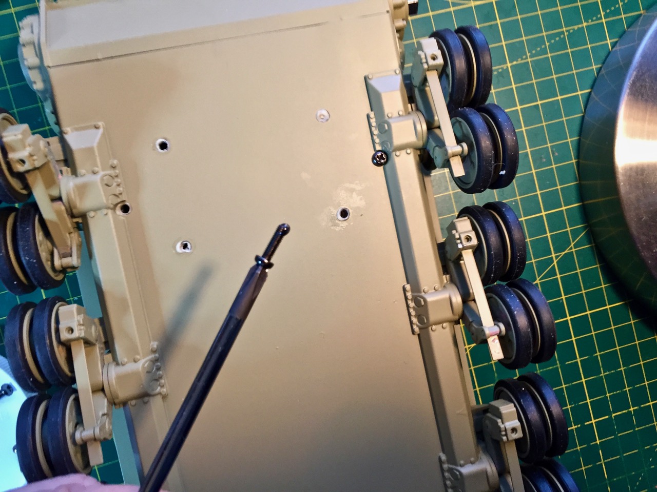

Fitting the gearboxes is fairly straightforward, but it becomes immediately apparent why the standoffs need to be glued to the deck floor first. On that topic, i realise I made an error earlier about which Full-option tanks have gearboxes mounted on standoffs. So far as i can tell now, they all do, the main difference is- however- that with the Pz IV the retaining screws pass through the spacers into the gearbox bottom plate, where with other models the standoffs themselves screw into the gearbox baseplates, and then receive retaining screws through the hull floor to secure the boxes.

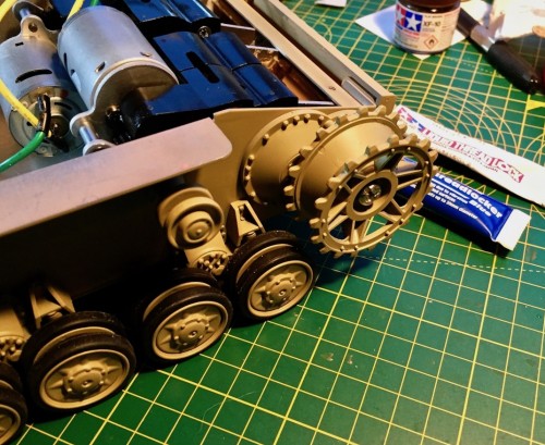

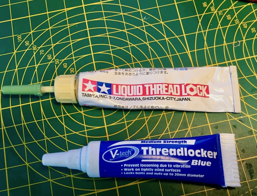

Tamiya recommend the use of thread lock for most of the major metal components. On other models I tried three different types (one shown below adjacent to Tamiya version), before I began using Tamiya'sown product. The trick is to find a thread lock that gives extra security to a screw or bolt fastening, without making it impossible to remove in the event of component failure (i.e. duff gears, or failed suspension bearing). That would be thread lock deadlock..
The other factor in finally plumping for the Tamiya product is (aside from it's presence in most kits..) that it has a convenient nozzle for dispensing it's goo, not unlike my preferred cement- Revell Contacta Pro.
Also indispensable is a screwdriver with a magnetic head, but I've found you can also retain the screw on the driver with a smidgin of 'blu-tack' (or even chewing gum) when you need to put if in hard to reach places. Just remember to remove the temp 'adhesive' later. In fact, I've also used droplets of Tamiya Threadlock for the same purpose..

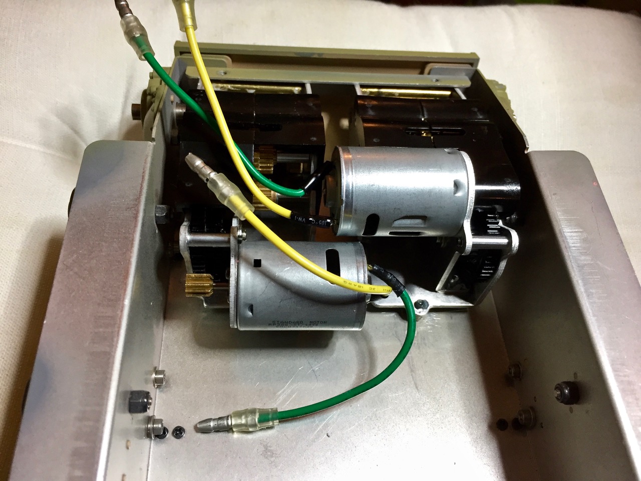

Here the drive units are installed:

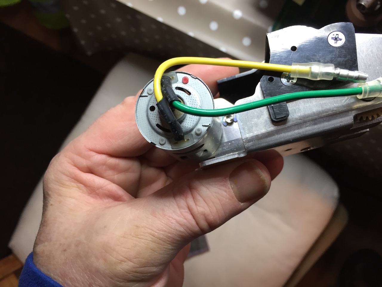

), I noticed this wee red dot on the dc motor. As far as I'm able to tell, it's Tamiya's way of indicating the positive terminal. Ok, for dc motors polarity is not a big (up in smoke) issue; but I like to have wiring diagrams to refer to, and am thoroughly baffled by the colour scheme on the DMD/MF units...and lack their of polarity indicators. Och well, so long as it works, and it probably will if you follow their instructions to the letter.

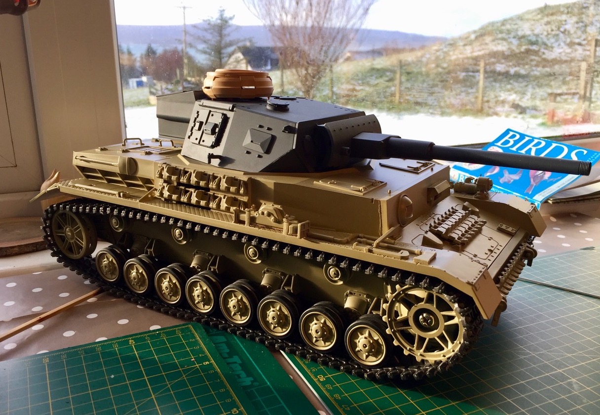

The tracks were as easy as the sprockets to fit, and everything lined up nicely..(compared with one or two HL builds). Tamiya instruct the builder to remove five links from the tracks and connect them up (pin heads innermost.).
The idler tensioner increases or decreases tension in 30 deg increments. In the event, I'd guessed an optimum starting position, and so no adjustment was needed.
Yippee.

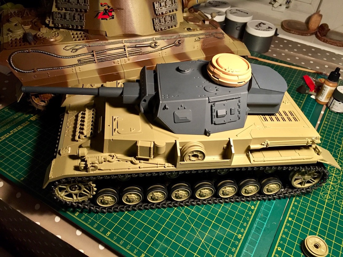

Here's an update to it's general look from today (notice the snow in the background. Brrrrr
). Yayyy..'it's beginning to look a lot like' ..................a tank not Christmas

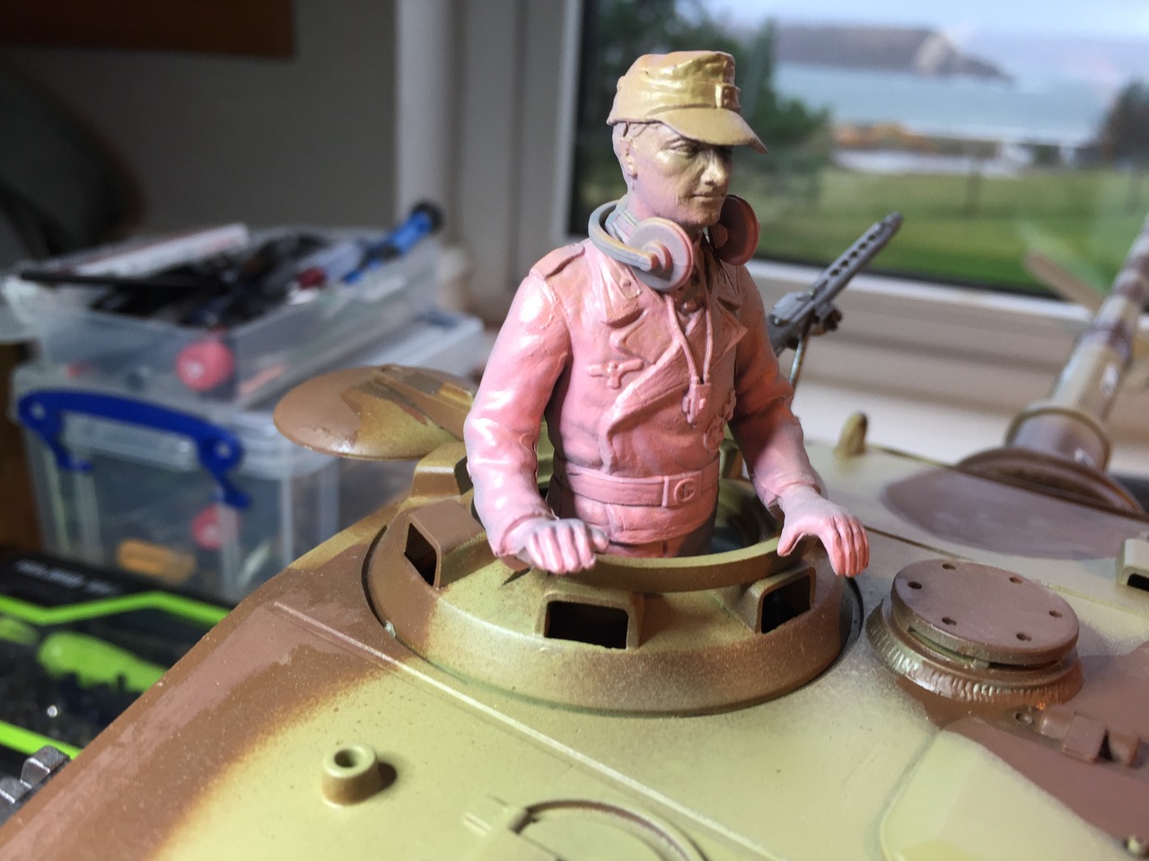

He's a reminder of the fact that I've not yet painted a figure. Indeed, I don't have flesh coloured paints as yet. But I'll get them in the New Year. He'll be the final stage in the King Tiger build. Right, well as it's chillingly below zero outside currently (not indoors luckily) and Storm Caroline is still showing her billowing white petticoats, I'm off for a well-earned cuppa
