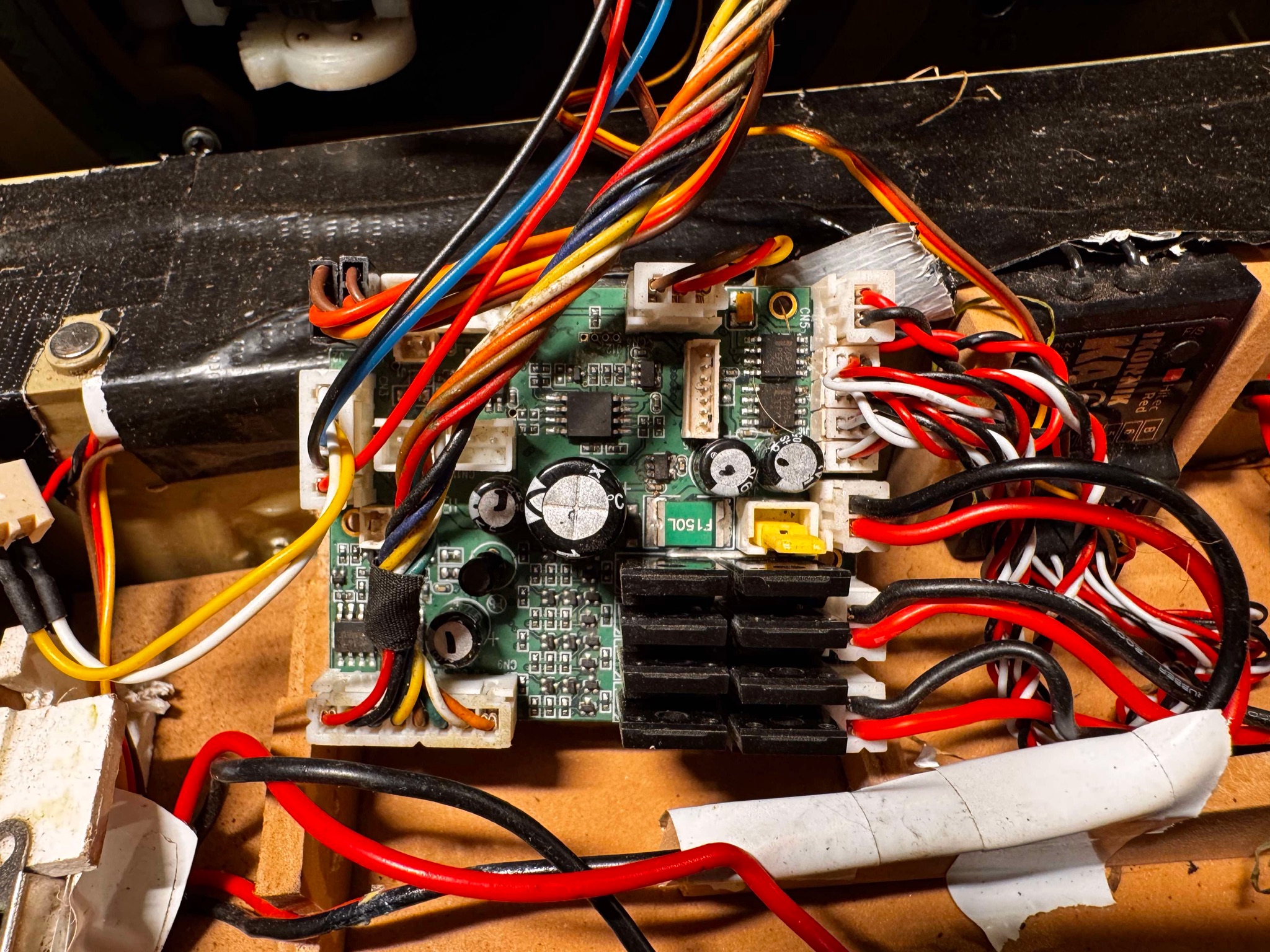

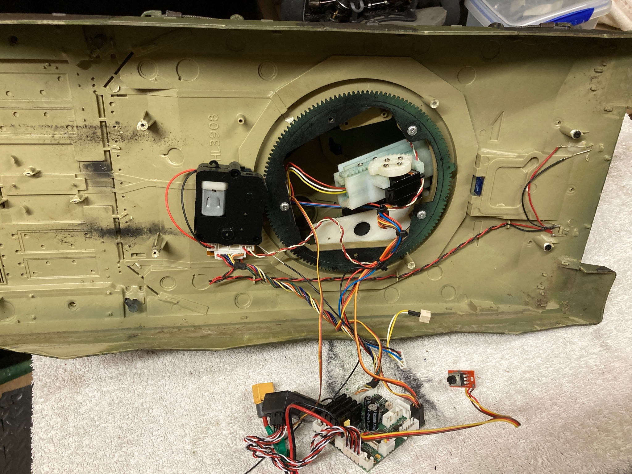

The spec of the tank includes a TK series board (of some description) that gives a very good Challenger engine sound along with good gun fire and associated sounds, but it is plugged into a standard 2.4 gig receiver that does not have an s.bus socket, so every function is plugged individually into the relevant receiver socket via its own "servo lead".

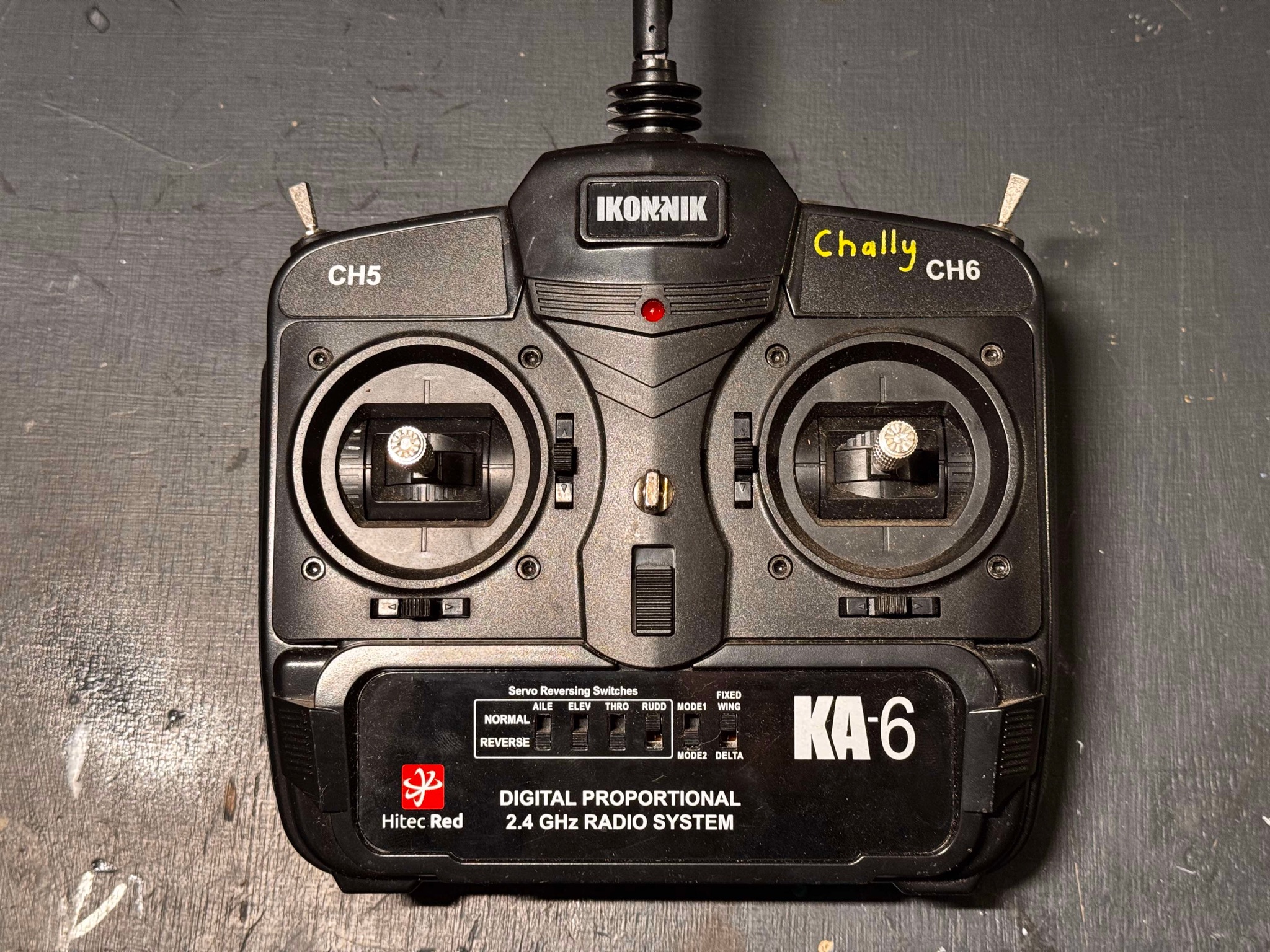

The HiTec transmitter that came with the tank has all of its driving functions on the right hand stick unit as normal, but ALL of the other functions work off of the left hadn't stick unit, and so by precisely moving this left hand stick up and down and sideways at very exact positions, it is possible ( I am reassured) to gain control of, the sound system on/off, the motor drive on/off, the turret turn left and right, the gun elevation up and down, the headlights on/off, the main gun shooting function, the machine gun sound and flash, and the second machine gun sound.
I can make all of the above work - but not necessarily in the right order (like a Morcombe and Wise sketch with a famous composer) .......and most definitely not when I want it.

- The radio works fine, but is not ideally suited to the TK board.
- FDF93166-71F7-4C99-BE23-CEC6CF2285B5.jpeg (1.05 MiB) Viewed 4938 times

- The top view of the TK board next to the Hitec receiver.
- 328CFCE3-616E-4D06-A1A7-4BCA987CC669.jpeg (948.53 KiB) Viewed 4938 times
- It’s a TK board - but what type?
- 667E7934-3148-4B2E-8944-60A9018D9331.jpeg (796.44 KiB) Viewed 4938 times

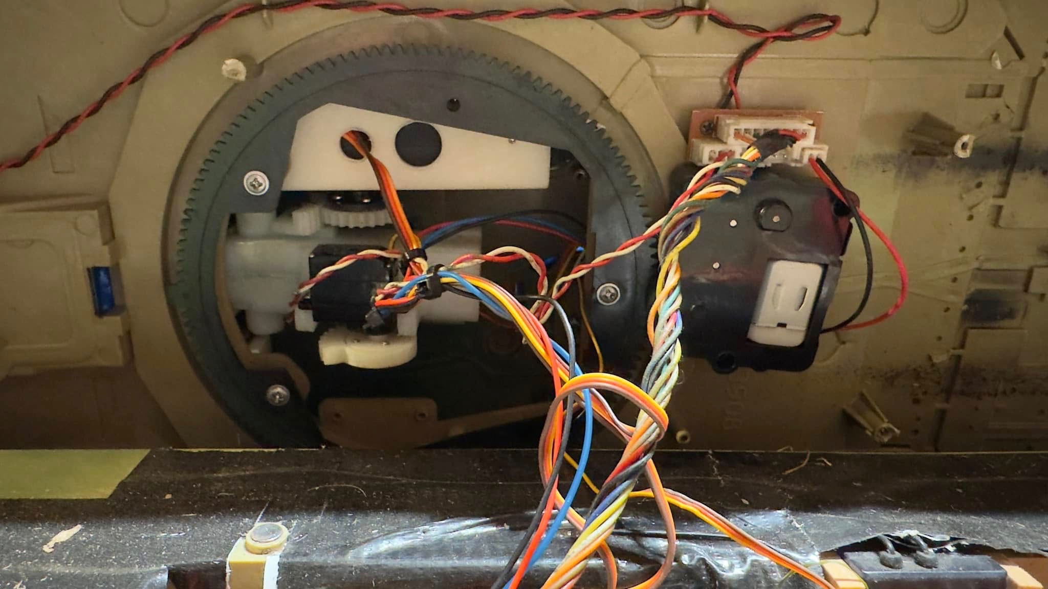

- Turret connections.

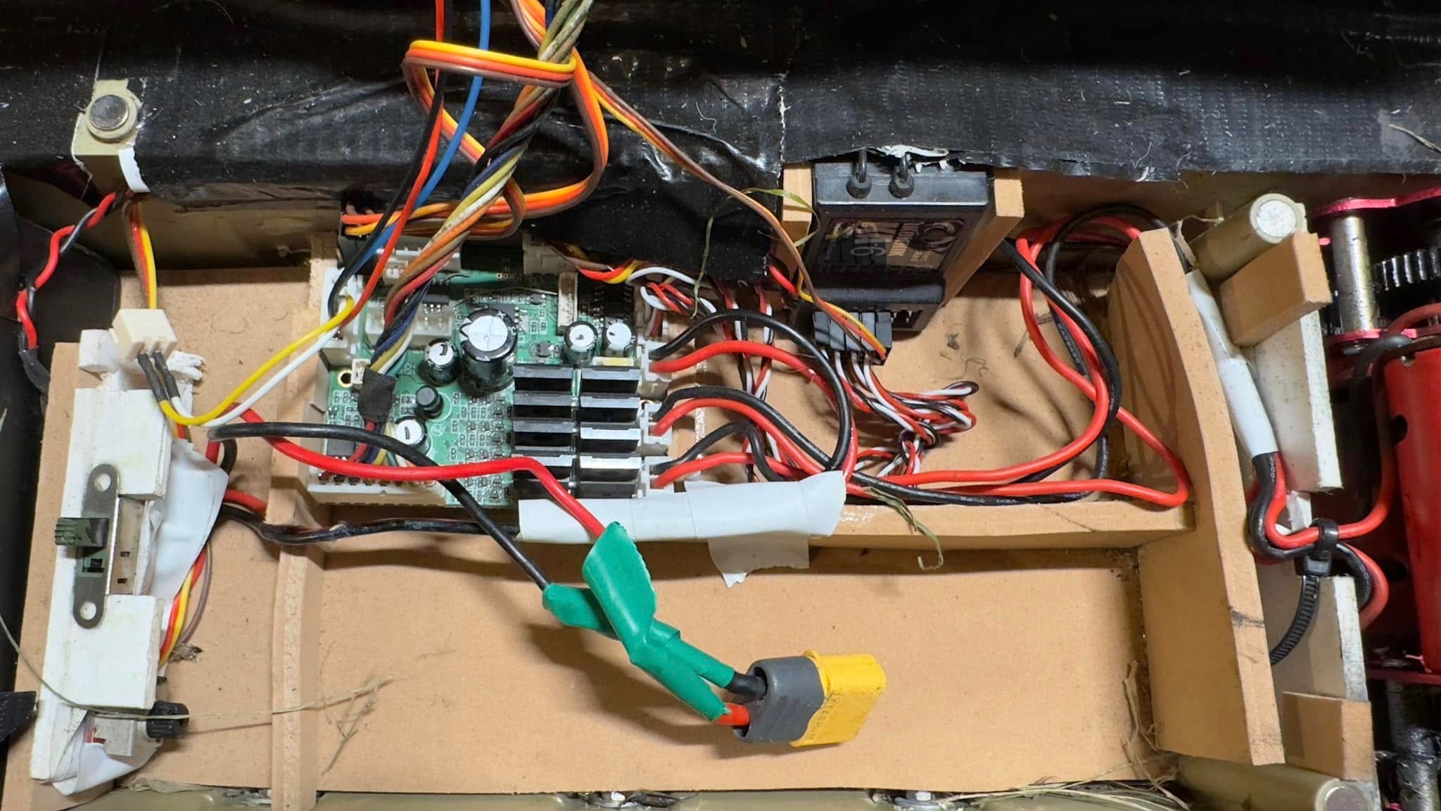

- Overall internal layout.
- 990F4490-B147-4565-B5C1-B1BB42624B7C.jpeg (323.57 KiB) Viewed 4936 times

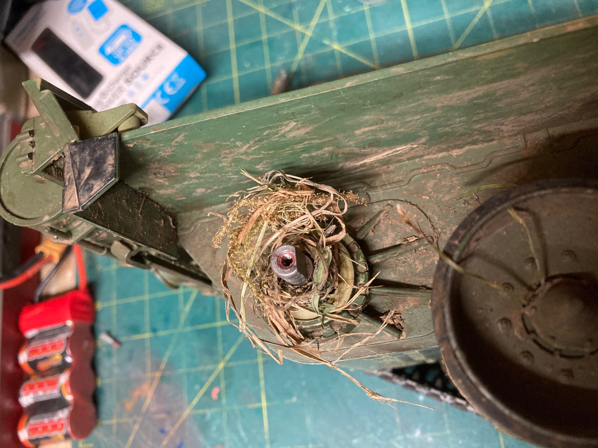

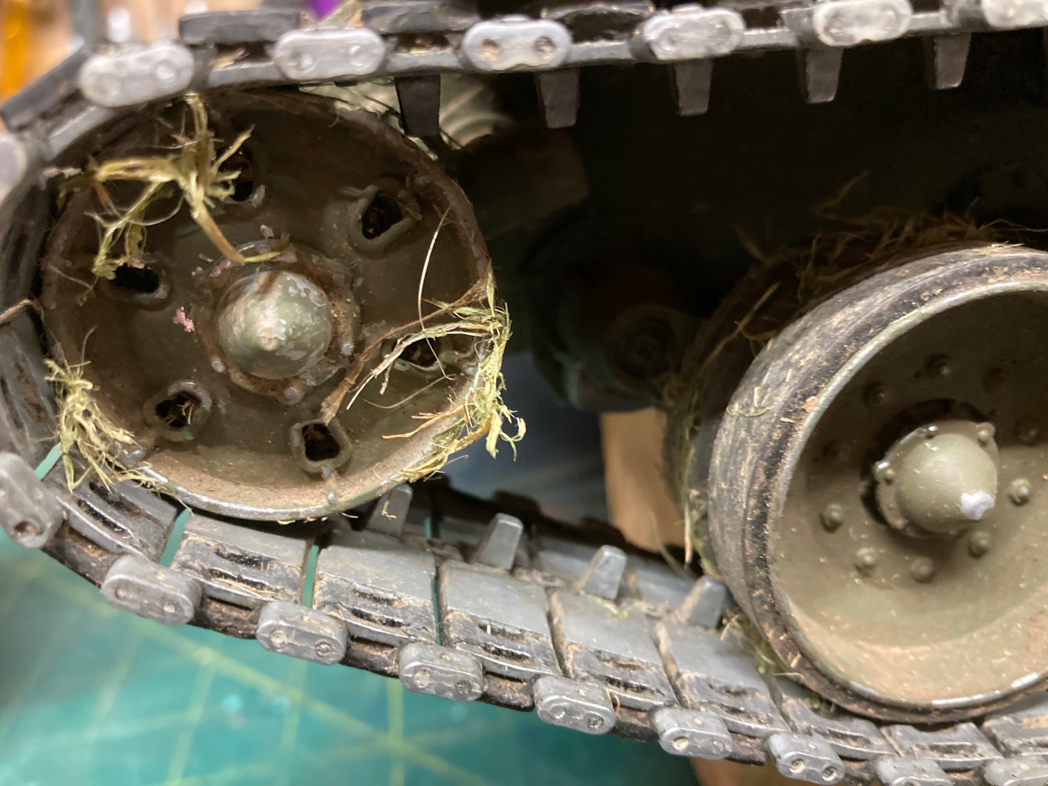

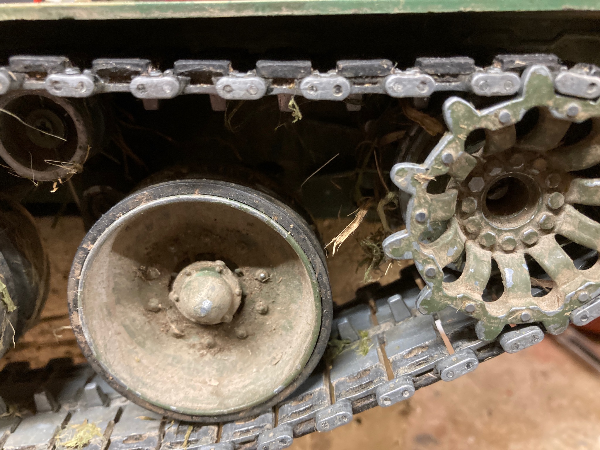

The clean-up started with removing the sprockets and tracks. Grass had wound itself around the sprockets, return wheels and rollers. The return rollers were unable to turn at all, and the dried on mud had dried quite solid underneath..
As the grass was unwound under the sprockets I could see that the tank had been running with no axle bearings - not even the original plastic bearings, so I will need to check the gearbox bearings carefully to see how they have stood up.
- Rollers solid and unable to turn.
- AA82C30E-C475-455F-8765-B482ADD89E86.jpeg (705.63 KiB) Viewed 4830 times

- Grass axle bearings?
- D19D277E-5D89-4EFD-B0AA-52DC88706A9C.jpeg (827.9 KiB) Viewed 4830 times
- No plastic or ball raced axle bearings fitted.
- 4AE8796F-A00A-4503-915D-EF08EA5D8747.jpeg (819.36 KiB) Viewed 4830 times

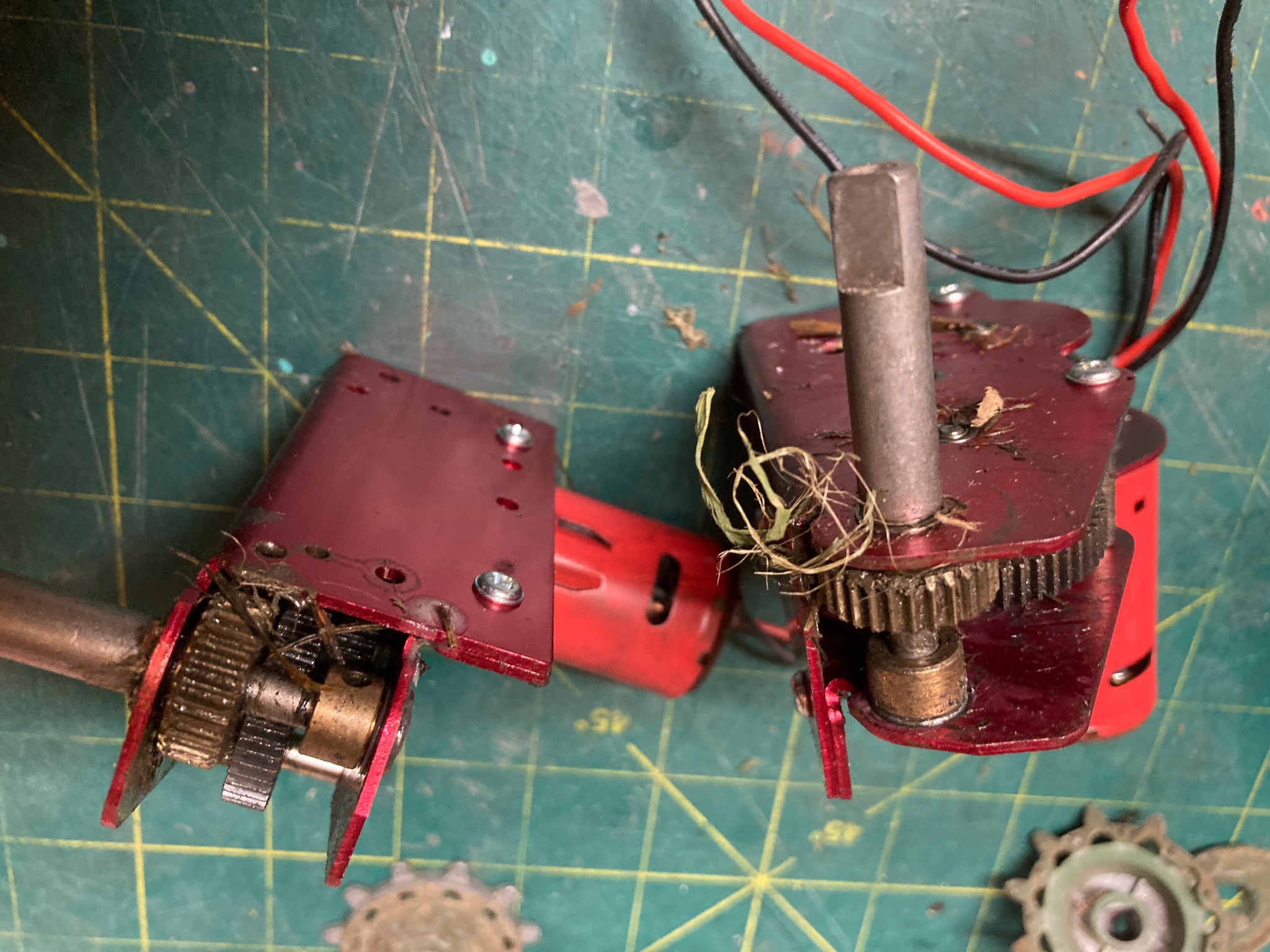

- Gearboxes will need stripping to clean and check for wear.
- 3B205F1B-76A2-4BFA-82FA-A3B11F89935D.jpeg (735.34 KiB) Viewed 4827 times

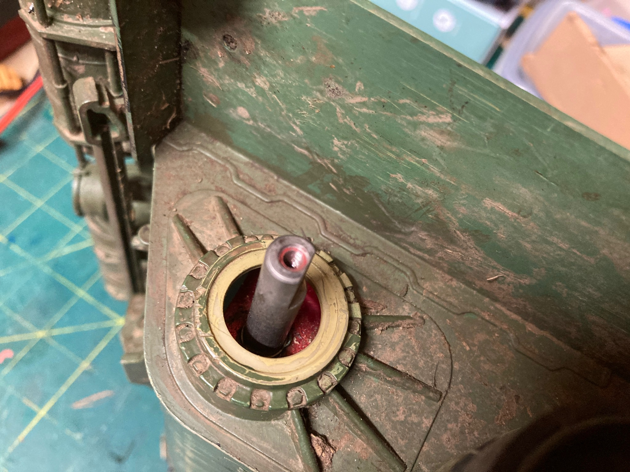

Once the inside of the hull was emptied the clean-up can begin. I also decided to grind the flange smooth around the profile of the battery box to tidy it up a little ready to have the battery door glued in and sealed.
With an hull empty but with the metal wheels still in position, I was surprised at how flexible the hull was - it was very easy to twist it without too much effort. Glueing the battery box door cover in place may help this a little and sealing it will help to keep the inside dry and clean in the future.
