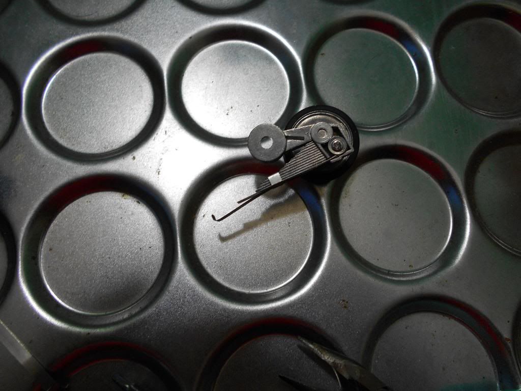

This first photo shows three versions of the suspension... top ..the Taigen... below that the Heng Long... the one on the right.. the final mod... a combination of both...
There is so much wrong with the Taigen... I can see why dealers are trying to dump them are low prices... when installed...they offer no suspension at all.. pushing on the top of the hull gives no spring action...TERRIBLE... Though very pretty and well detailed..they are no better than "static" copies on regular models ...there is so much complexity to the design... but it simply does not work
There is an internal spring ...which is supposed to close the two arms... then the leaf spring with is supposed to be the ride suspension... it's too stiff...and does not allow the two arms to work individually
This is a photo of half of the suspension unit...the side with the leaf spring
It's actually very "good" looking... as it has a dual leaf below the molded imitation leaves... and is then shackled together with a nice metal band...I found looks aren't anything... as it doesn't function at all

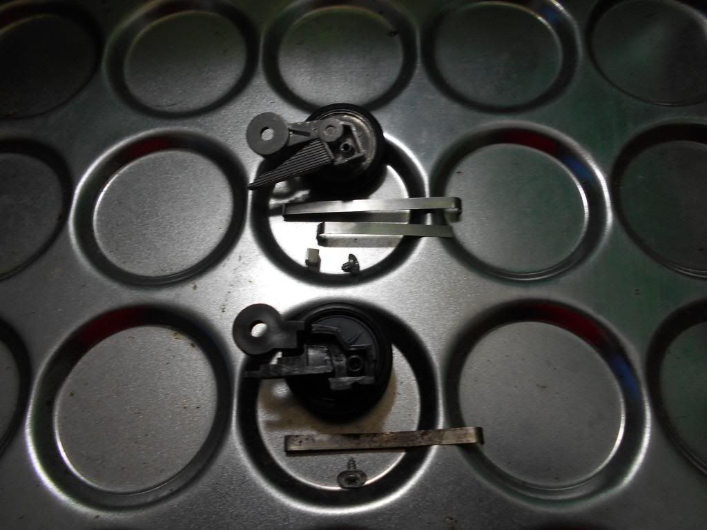

By comparison..the Heng Long looks cheaper... and has a much simpler design...and is comprised of less parts...the big difference is... the Heng Long does work ...VERY WELL I might add ...you not only get the action of the arms...but the movement as a unit as it pivots on it's center point...
After a few hours of changing over one bank ... I realized how bad the Taigens were when I bounced the tank with my hand...I then also found I could not compress the Taigen suspension with my hands as an individual unit :thumbdown:

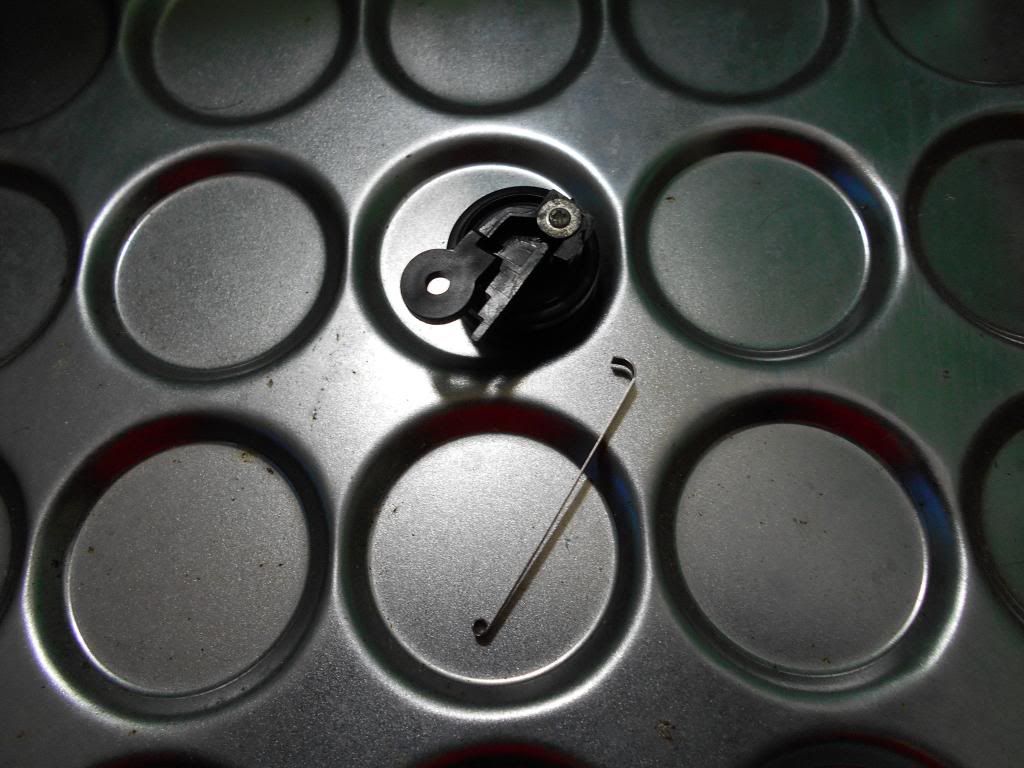

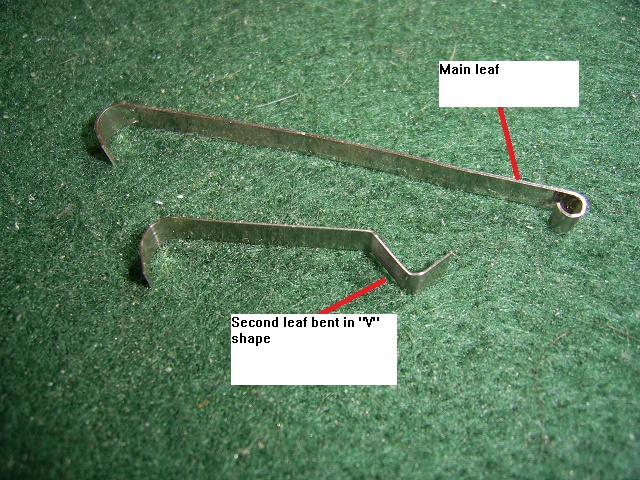

Not wanting to waste the investment I had already made in the Taigen units...I broke both the Heng Long and Taigen down to their most simplest form... and analyzed the parts...first thing you will notice is the Taigen's Leaf... is longer... it does make a difference ...small ... but it does ...in a bad way
The Taigen has two individual leafs ... the Heng Long has one ...which actually is the reason it works better than the Taigen...The Heng Long leaf is "Spring" steel... the Taigen's are as well...but has lost it's spring due to what I think is a polishing process ...not hardening ...but softening the steel... causing it to loose any spring effect... the shorter one(the stiffener leaf) being the better of the two

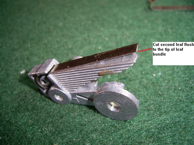

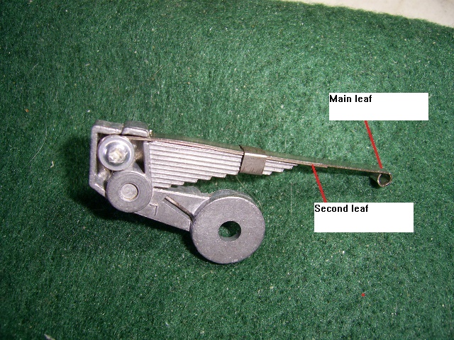

So I take the long Spring steel leaf from the Heng Long... and combine it with the Shorter stiffener leaf of the Taigen and a few of the other components and make this
The combination is perfect IMO... you get the "bounce" and the "tilt"...but just a tad stiffer than the stock Heng Long ...The strength of Metal over plastic in this one weak area of the Heng Long Panzer IV...as the plastic tends to "tweak" sideways
The topping to it all is it's more adjustable as well.... I can easily make the suspension softer by removing the shackle that clamps the leaf ...allowing the Heng Long spring to take full arch...the stiffener spring then takes full function as well... as it reinforces the compression of the arms at mid point :thumbup:

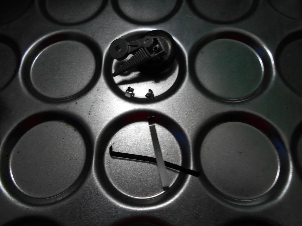

The following picture are the parts that go into the scrap bin ..junk pile ...or garbage
the Heng Long casting is worth keeping ... the Taigen spring... :thumbdown:

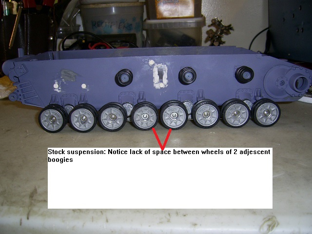

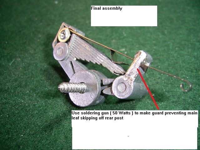

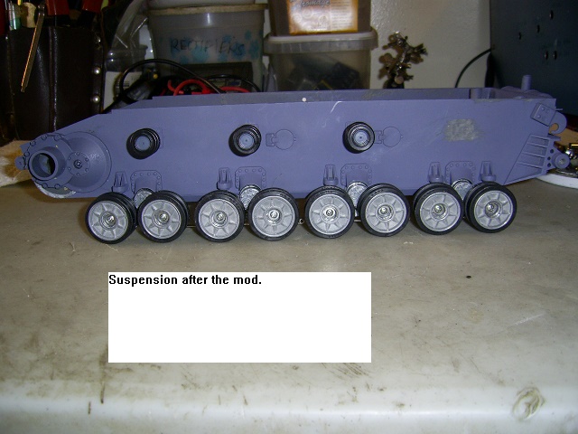

I have an Asiatam metal suspension that I bought a couple years ago for my old panzer IV.
When I decided last week to install it on my newer tank, I found out that not only it looks the same as the Taigen metal suspension; but it shares the same flaws... @)
So before I even knew about this thread, I proceeded to fix the suspension to my liking...
I took an approach different than yours...Here's some pictures with comments and a short video to show the difference before an after the mod....

How well does yours compress...that's what I didn't like about the Taigens... they just didn't have any "spring" to them... they would just pivot on the hull support... so no "real" suspension per say 8O
