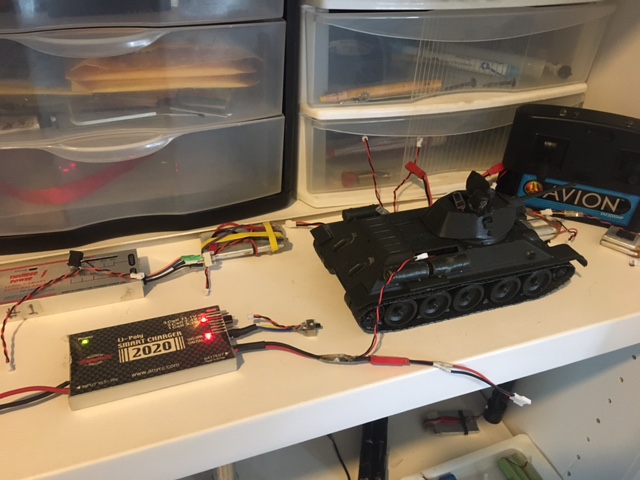

refueling underway
refueling underway

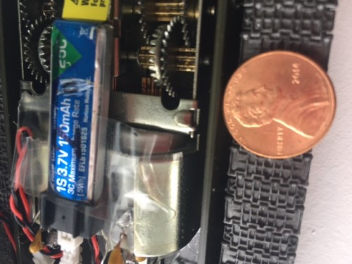

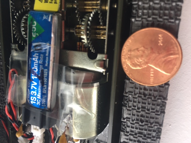

This T-34 runs off a 1s 140 mah lipo! That's the beauty of these all matal Tamiya gearbox, with the right motors they are very efficient and produce a lot of torque with low current consumption.

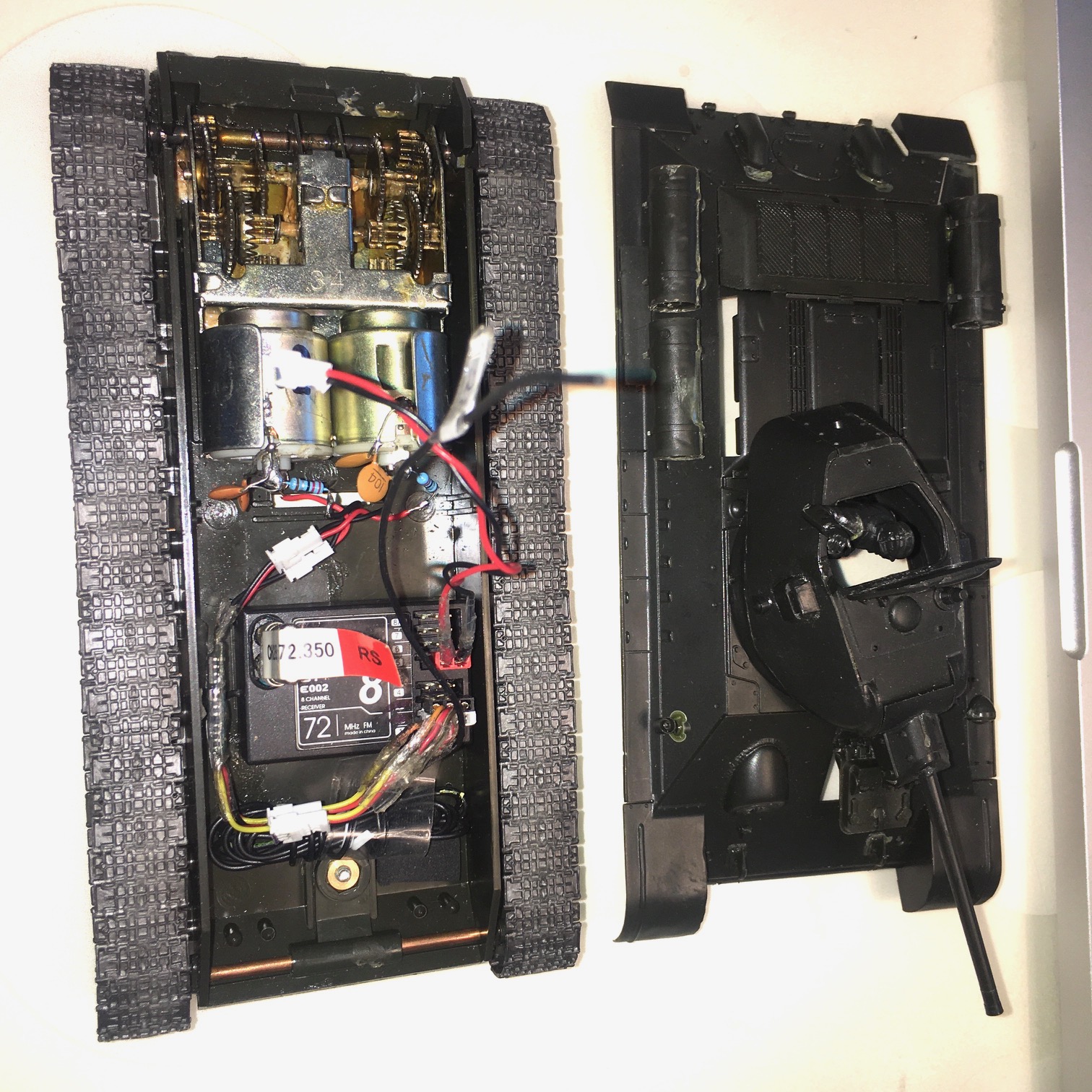

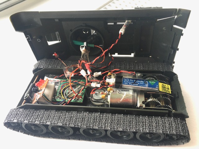

Looks like a bit going on in there. 2.4g with I\R battle system.

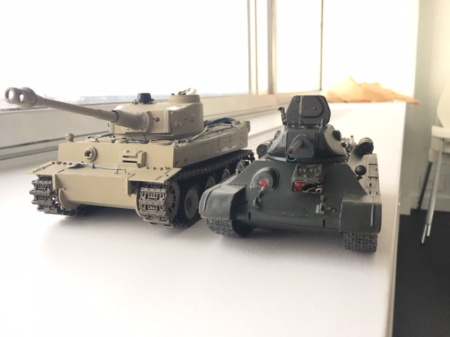

Pair of Tamiya 1/35 scale battle tanks. May be the only set in existence. I actually have a trio of these tanks including a Sherman M3A8. So can have a 3 way battle against the Tiger.

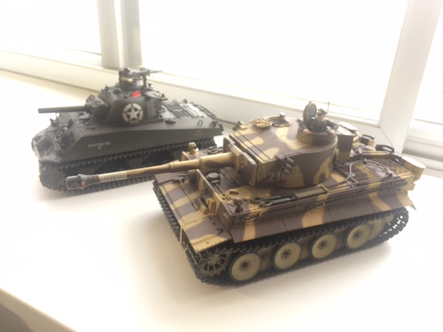

Excellent track system on this tank. Has a battle system for battle against a Tiger 1. 2.4g with I\R battle system with scorings (3 hits) LED display.

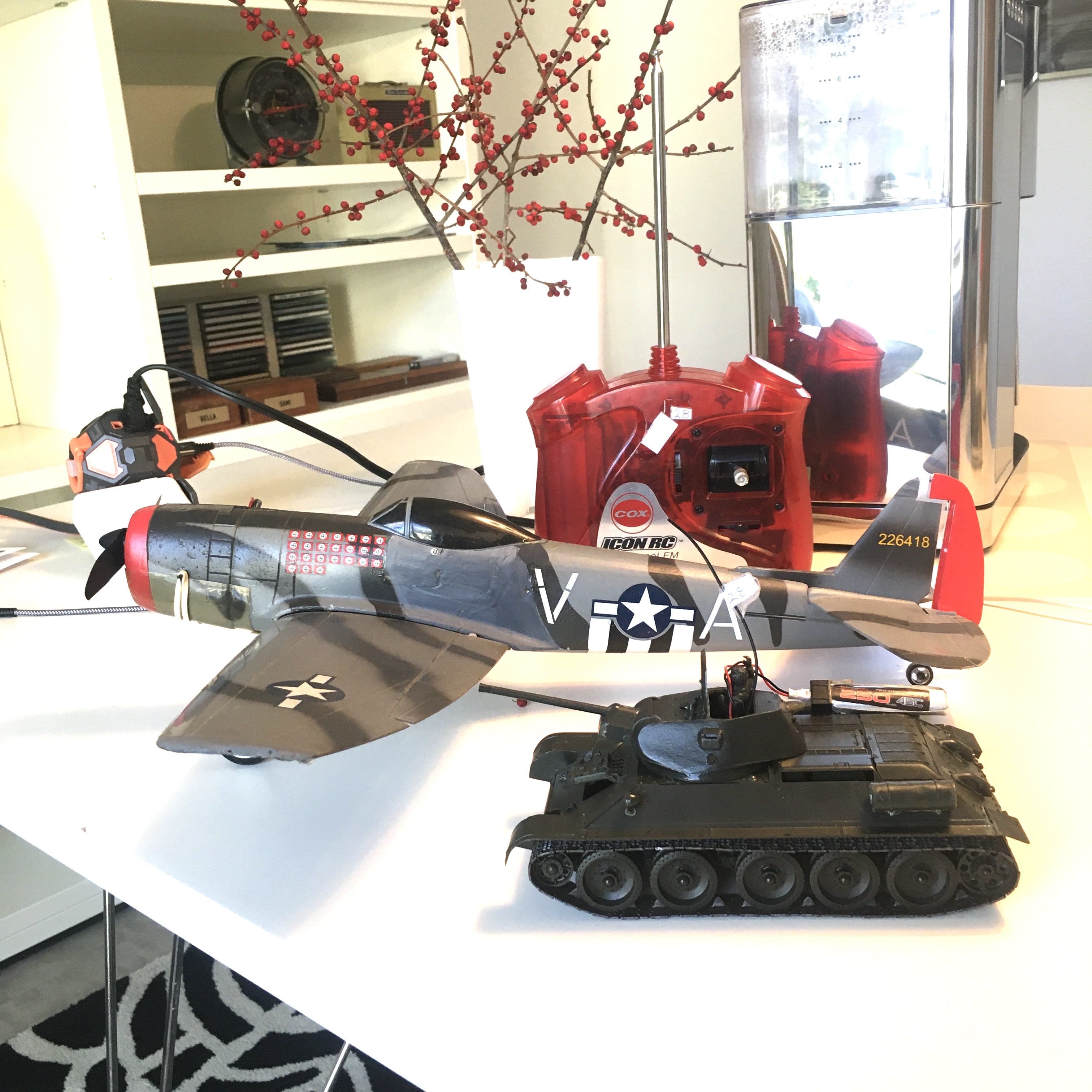

It is IRONIC that this ICON RC radio comes from a 1/35 scale radio control plane. This is a Cox P-47 from (2006), These were very popular RTF kits. This one is still on the flight deck and was flown last summer. Now the Transmitter controls this 1/35 T-34 as well.

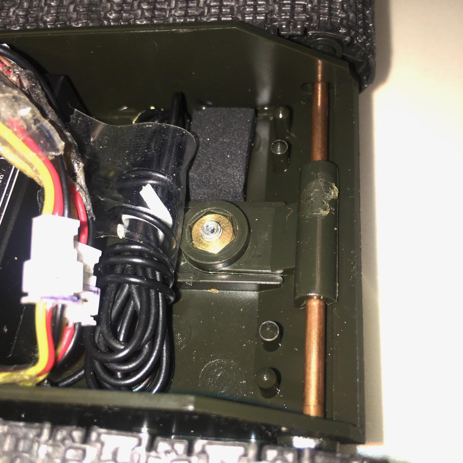

Inside view of the forward track tensioner.

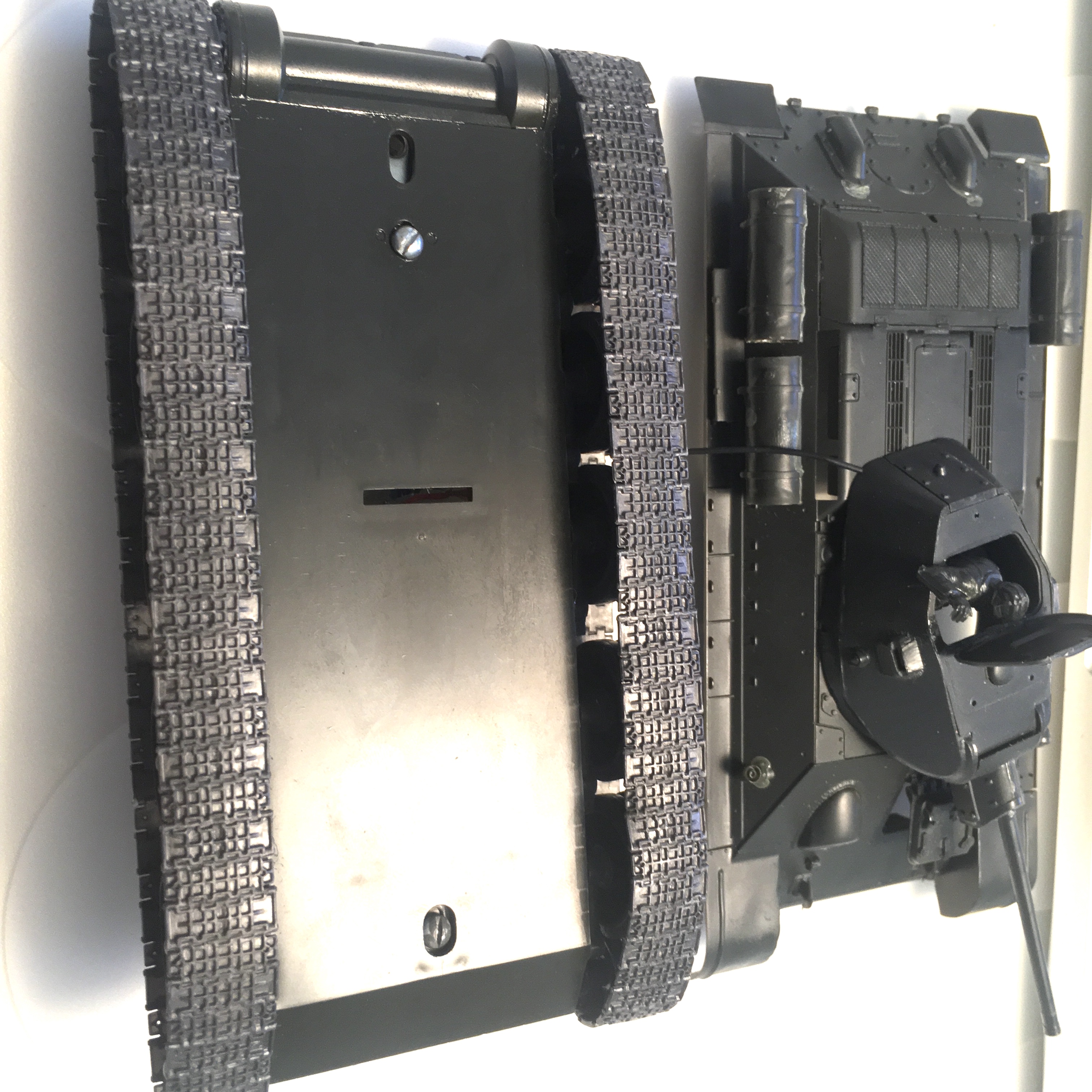

bottom view shows two track tension screw adjustments. It is the only one in my collection that has this feature. The "slot" is for a on\off switch that comes with the kit if it is a "motorized" version (single motor)

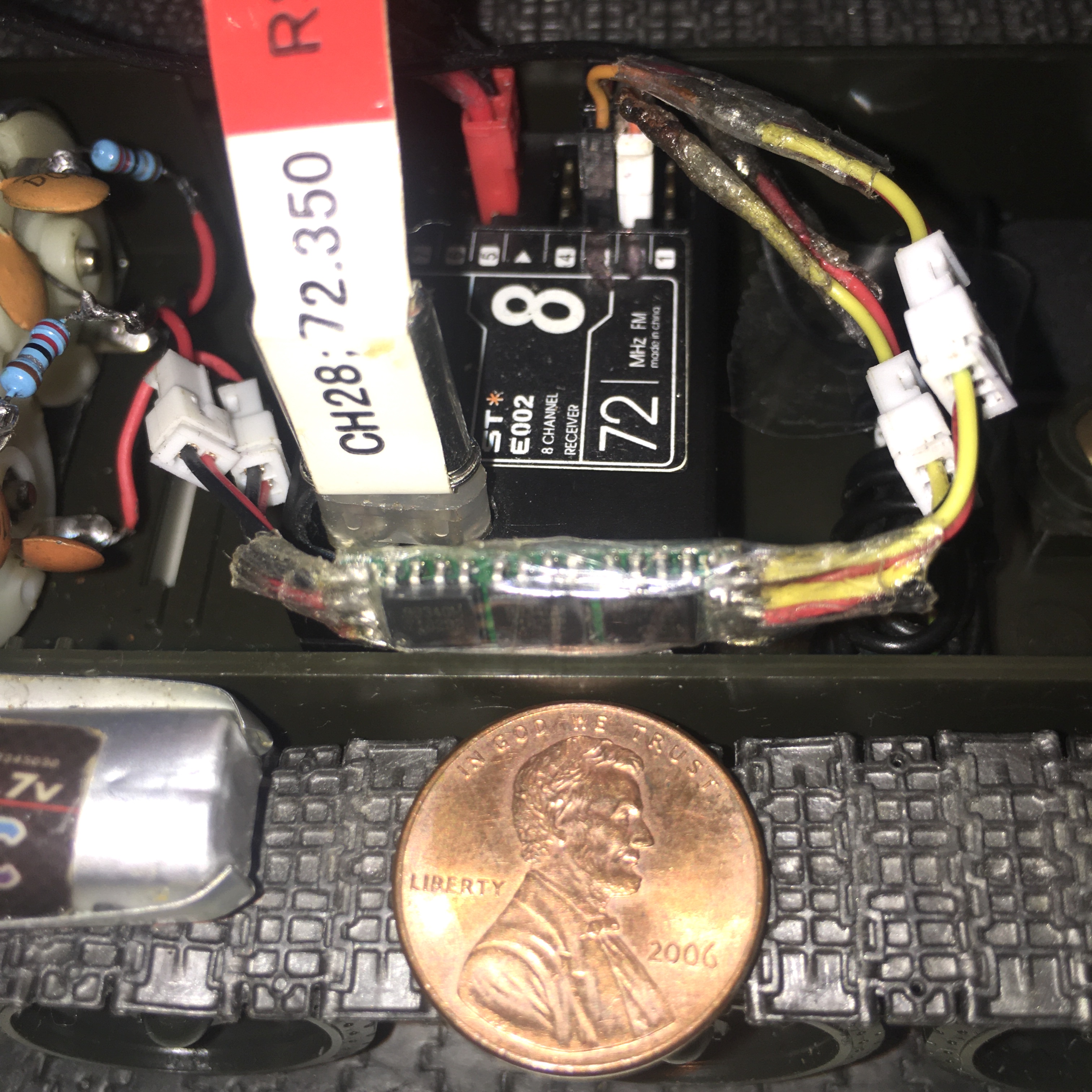

1 ohm motor decoupling capacitors visible in this picture along with 2.2 ohm motor tuning resistors. 72.350mhz FM (channel 28) vintage 8 channel radio system.
Here is the "Das Mikro" twin ESC with mixing. This is one of the smallest twin ESC's around, however, they only work with vintage radio gear! I can not get these to work with a DSM type radio gear.
Vintage aircraft radio gear with a modern twin ESC with mixing. "34" stamping visible on the gearbox. You can also see upgrade brass pinion gears on the motor shafts.

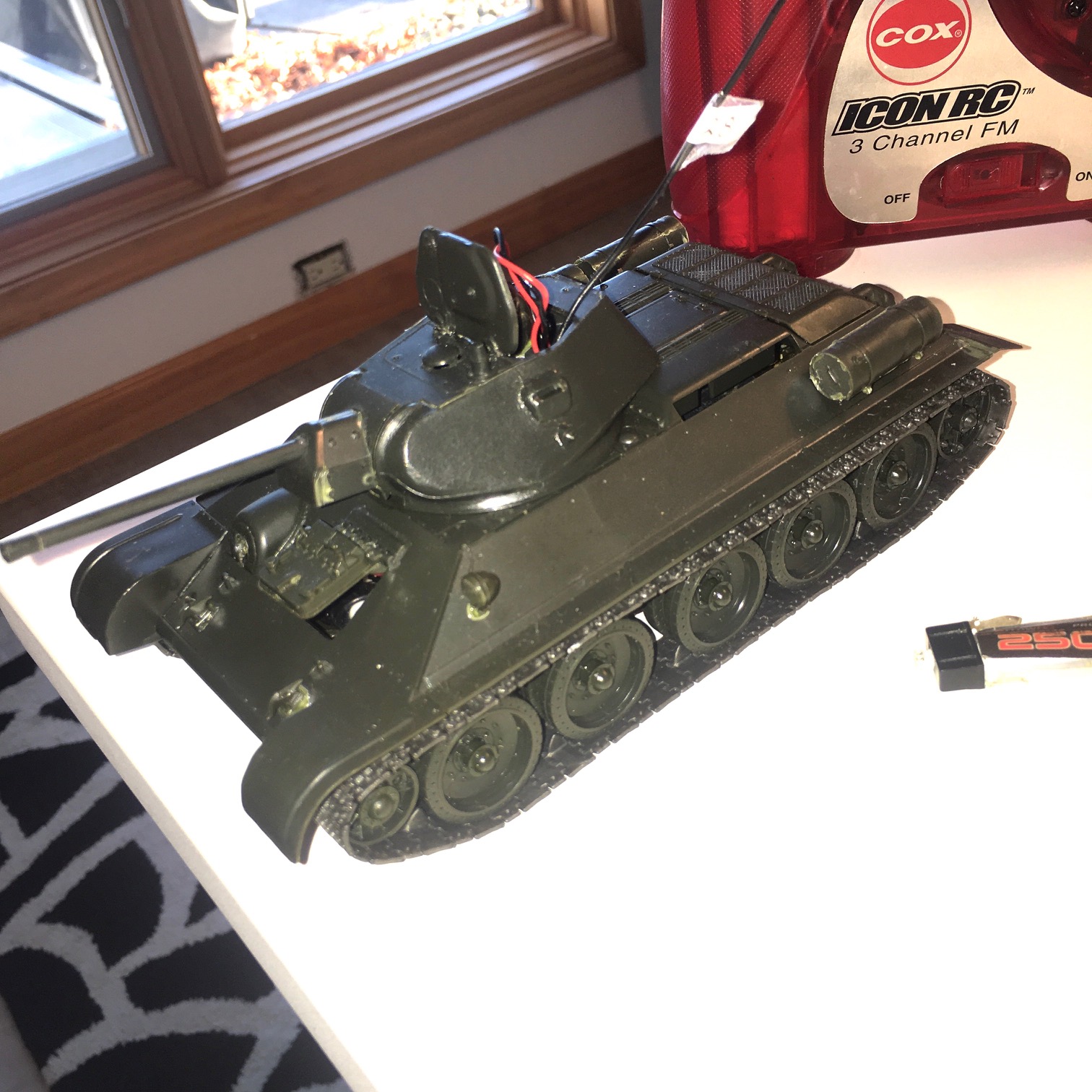

Currently using a vintage aircraft radio system in this model. Works very good despite its age. It allows me to repurpose this radio gear that would otherwise sit in storage. Circa 2007 (16 years old)
