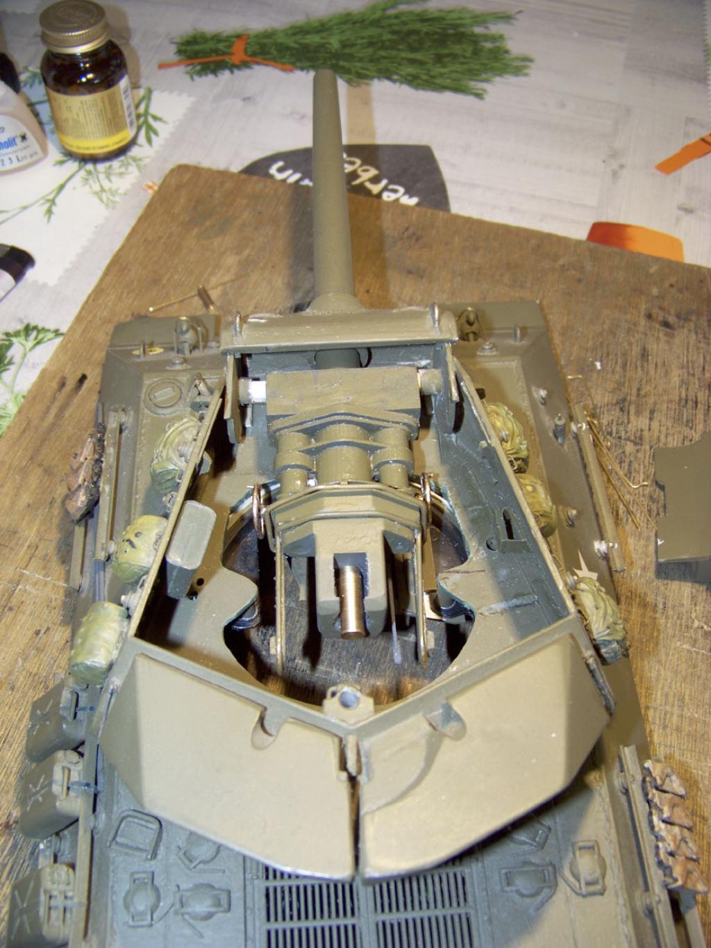

as I've said yesterday, I post some pictures of the construction of my M10 TD :
All the upper hull and turret are made of 2mm thick plastic card. The base of turret and the gun are made from an H.L. Pantatiger.

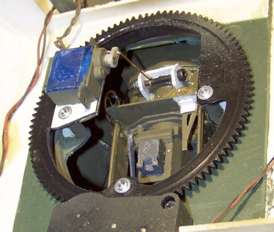

I've changed the H.L. elevation device for a simple servomotor without pot.

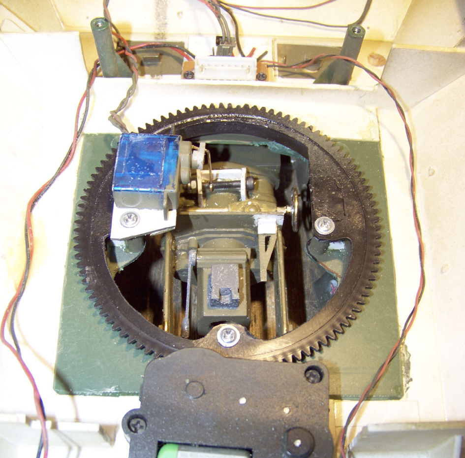

When I've changed the H.L. breech for the true one, I've modified the gun elevation system, now, located under the turret :
I hope that pictures shows suffisantly clearly the steps of the construction and gives ideas for other constuctors !
