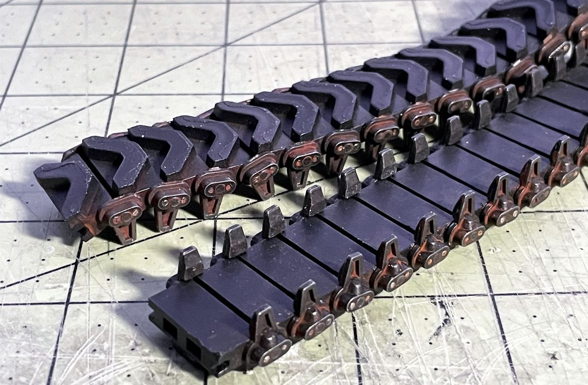

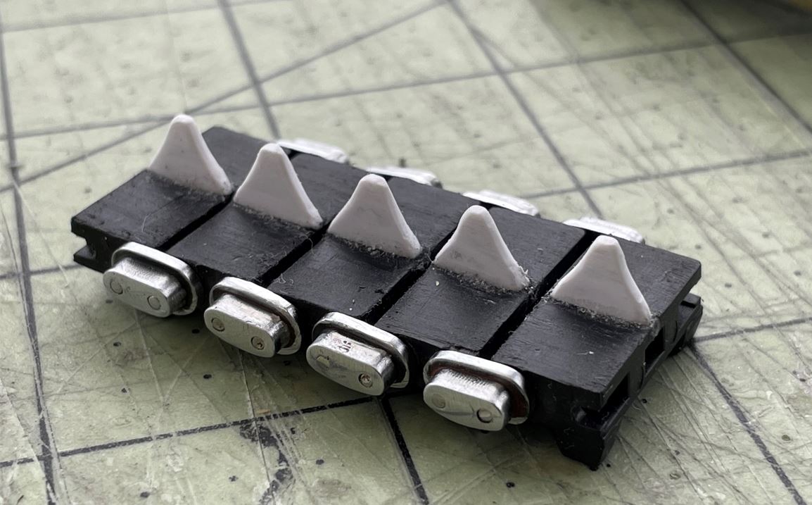

During planning, i did some validation on the use of the Mato metal/rubber Sherman tracks that come with their old plastic M4A1 RC tank. I could see that it had about the right dimension to represent the T85E1 tracks. The only thing to rework are the side pins.
A T85E1 prototype was made and proven to be workable. The side pins were removed with a hand file and a central pin was created in plastic and glued, after anchor points for the glue had been created on both ends. Looks solid. Modified metal Mato Sherman sprockets will be used with it.

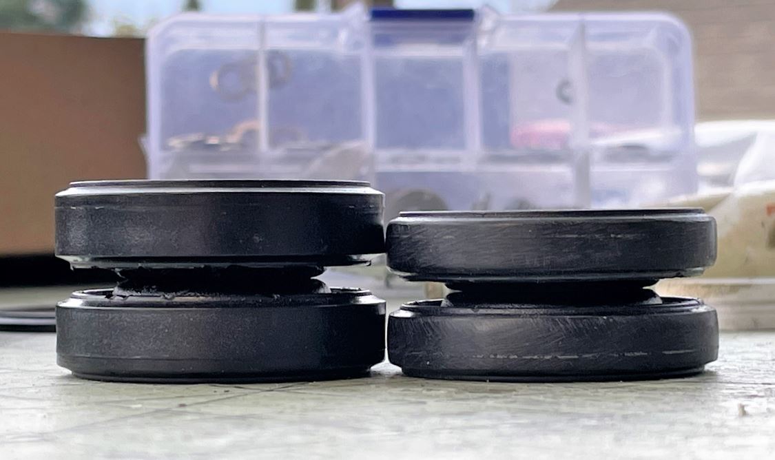

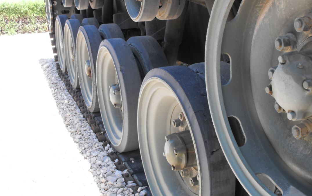

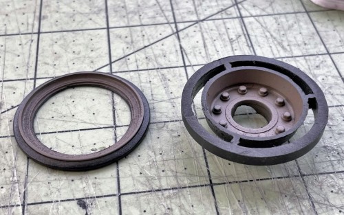

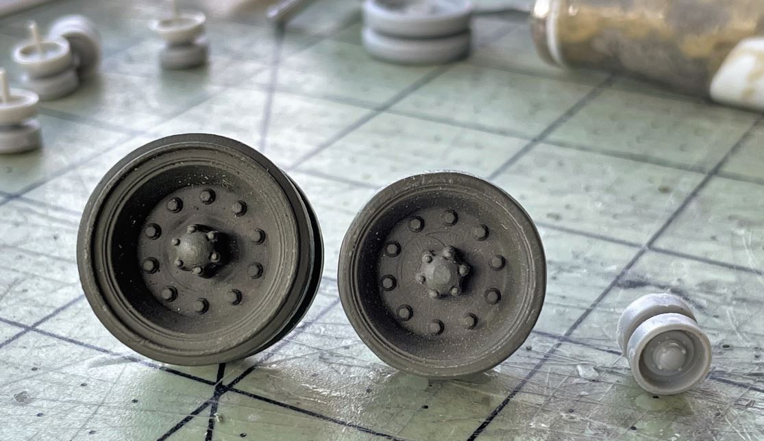

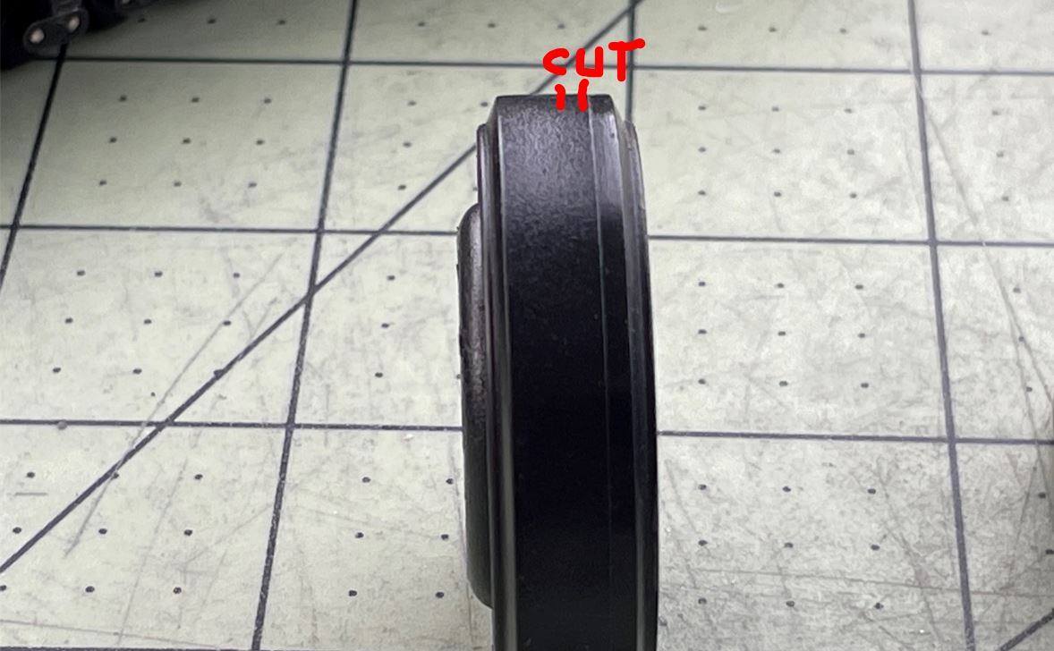

Another key are to pre-plan was the road wheel. We can see that the M-24 road wheels are quite thin to fit the narrow tracks.

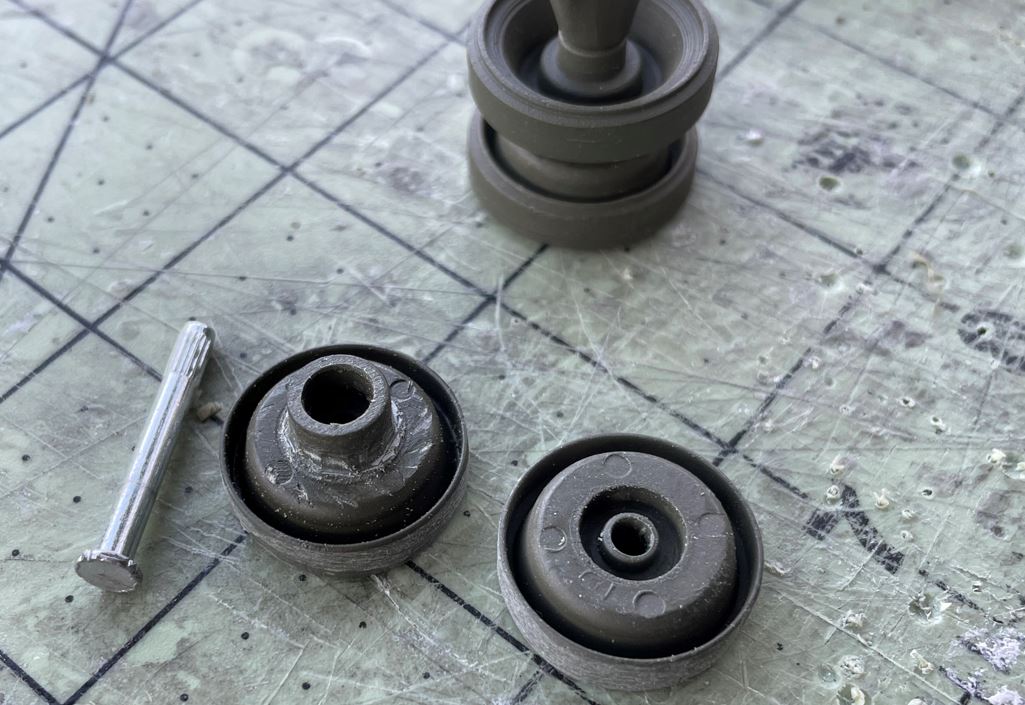

For a US tank, only the Heng Long Pershing and Walker Bulldog could be of use. However, these are way too thick to be realistic.
I decided to trim them a bit by cutting them in half at the line with a large Dremel fiberglass cutting wheel.
The two halves are then sanded smooth to re-gluing together.

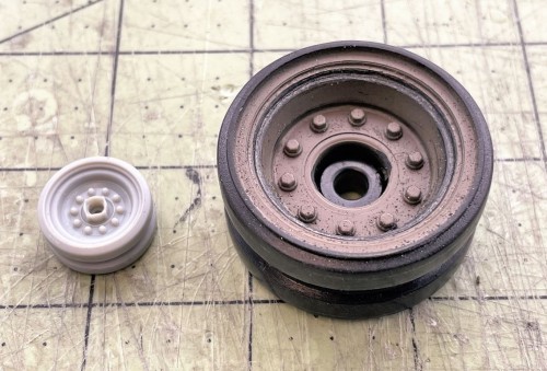

An here we have a thinner M-24 road wheel. The diameter itself is about 1.5mm to large but i manage to remove 0.5mm by reducing the thickness of the rubber. This extra mm needs to be accounted for during the hull creation and placement of the suspension arms. There should be at least 3.5mm between road wheel.
Shown here on the right is an example of thinned M-24 roadwheel with an original M-26 on the left. Need 10 of them. The idlers will be another rework of the M-26 road wheel.

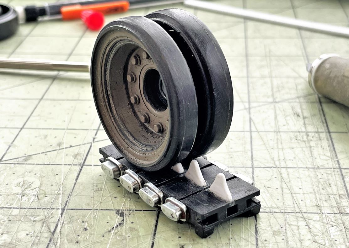

Shown here is the dry fitting of the prototype M-24 road wheel on the prototype track section.
Looking good.

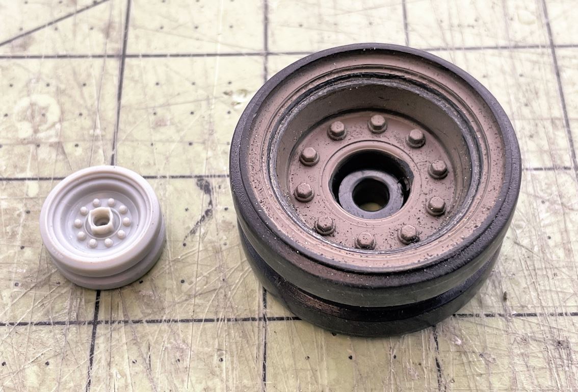

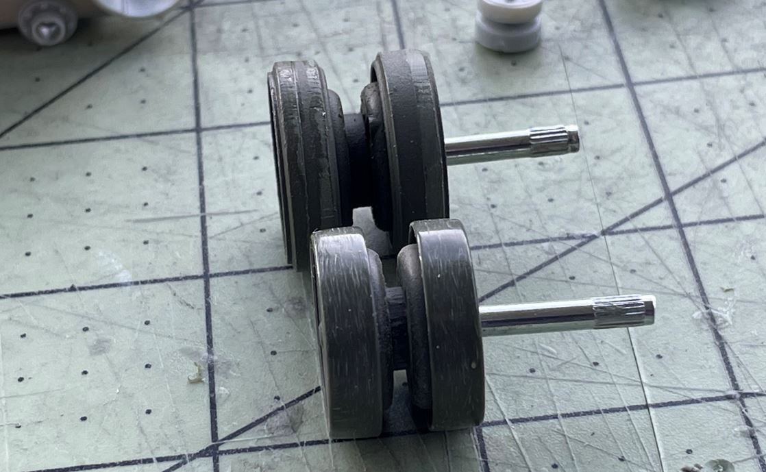

The return rollers have too much diameter. I managed to reduce the diameter of the wheel by removing the original rubber band and creating a new look. That is the best that could be done with limited work with a Dremel and nail file. Need 6 of them.
Looking good.

I made the return roller prototype a bit narrower as well.
This is the fit to the track prototype, looking good.

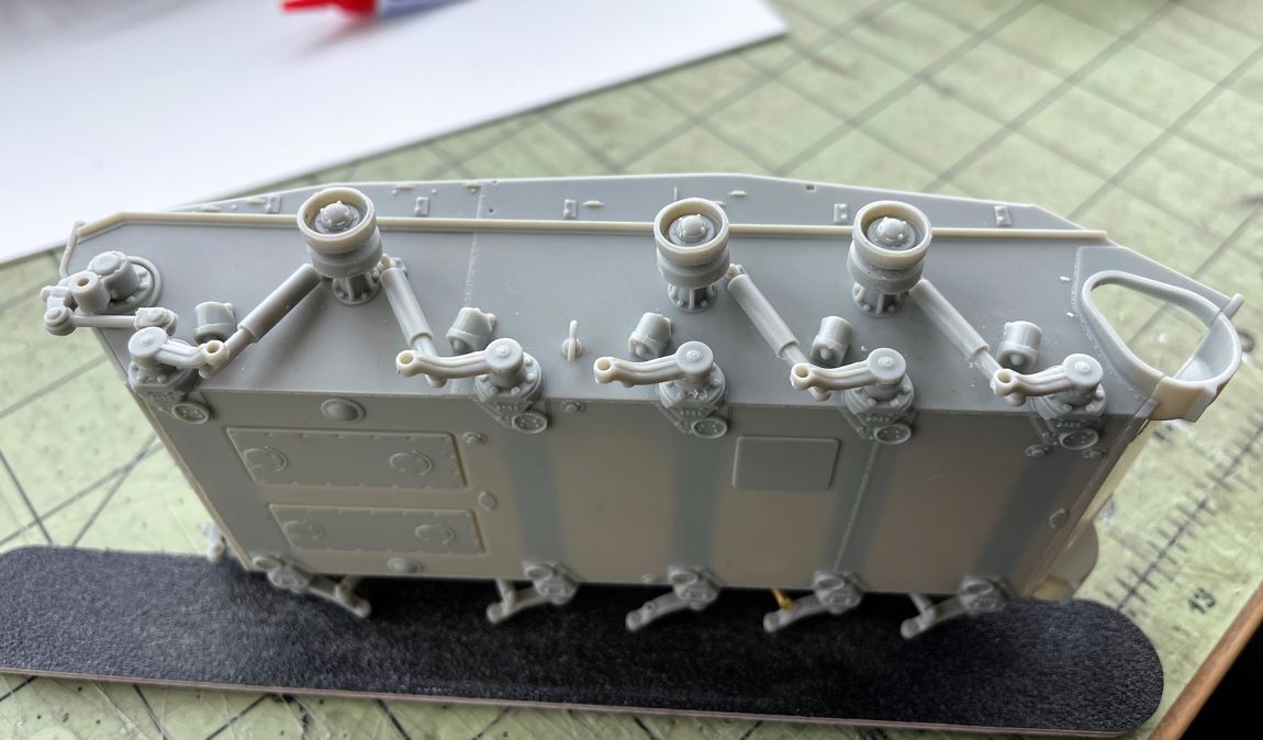

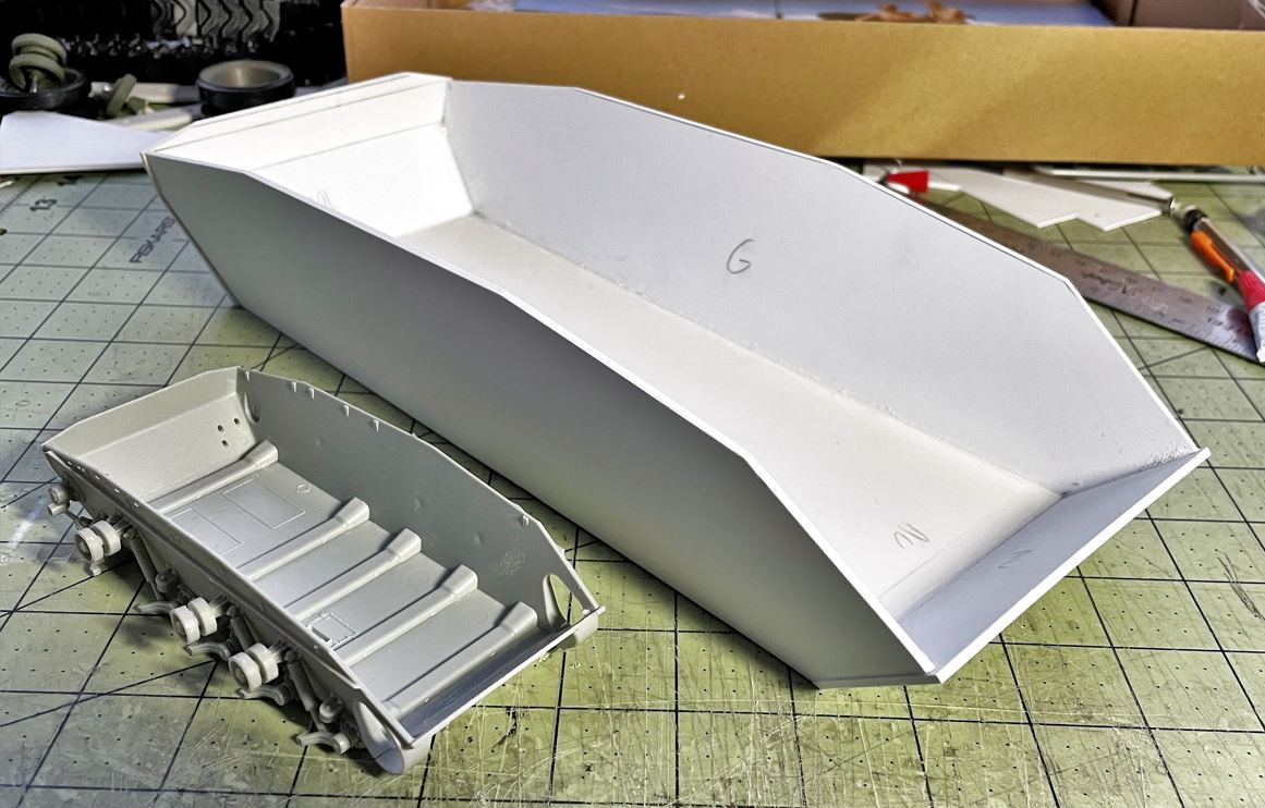

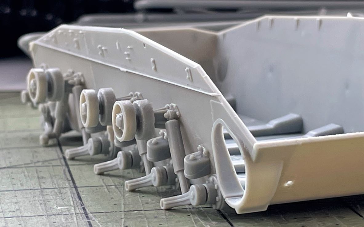

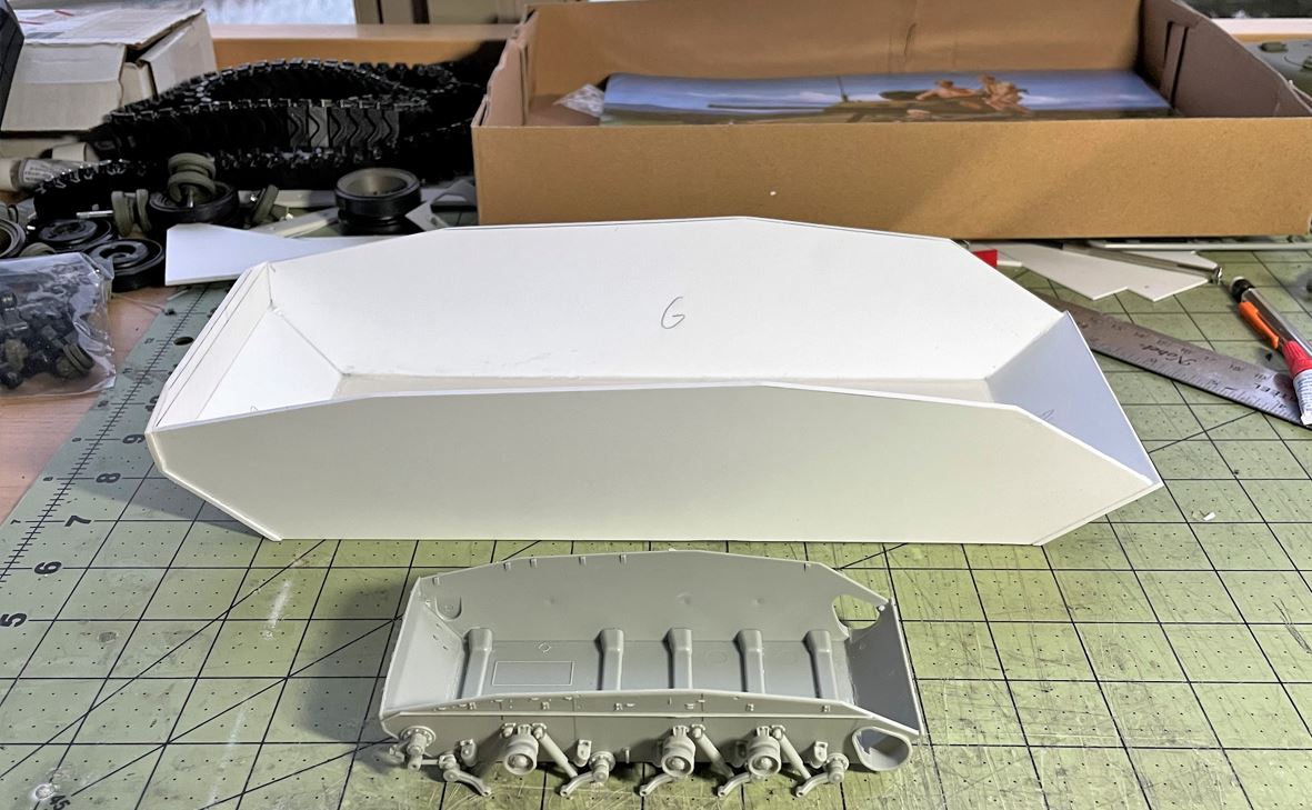

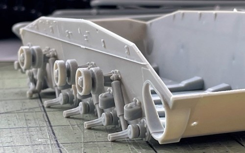

I decided to invest some time in building the Bronco 1/35 kit in phases to learn about its secrets, it will be at my side for the duration of the build. It is coming with working suspension, tracks, torsion bars... but no spring for the dampers. I guess it is a way to give the builder a new experience because in the end, it all need to be glued to ensure the road wheels are levelled evenly.
Heng Long M26 suspension will be used. But as the HL suspension arms are a bit longer than the extrapolated size of the 1/35 arm, this will need to be accounted for during the placement of the suspension arms on the 1/16 hull. Plastic and metal dampers are on inventory. I might have to use metal ones under the planned heavy Mato gearbox at the front. I'll see and decide later.
Overview of the assembled Bronco 1/35 lower hull and suspension that i used for analysis and calculations. Notice that the middle road wheel does not have any damper. It is planned to give it a torsion blade.

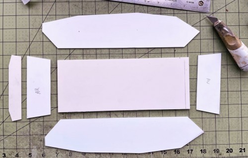

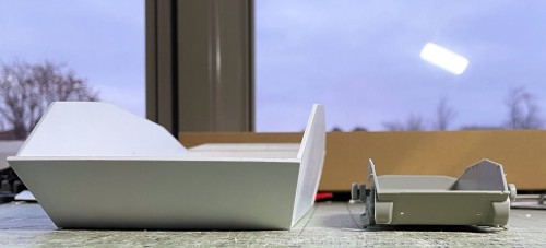

Parts are drawn on plasticard and cut. Because the road wheel have an extra 1.5mm of diameter, i gave the hull an extra 8mm in length to compensate. Over a total length of around 300mm, this extra length will not be noticed, but will allow me to give the 3.5mm of room between the road wheels, and adjust accordingly a mm here and there for the top.
Although these are flat plates, the Chaffee has complex angles on the upper rim to check and recheck 10 times before anything is cut. The base is 4mm millimeter think, the sides are 2mm think. It is important to properly reproduce the thickness of the armor when joints show externally. Reinforcements can later be done inside.
The lower hull main parts are assembled and compare well to the 1/35 kit.
The model as it stands today. Next step, the suspension and road wheels.
