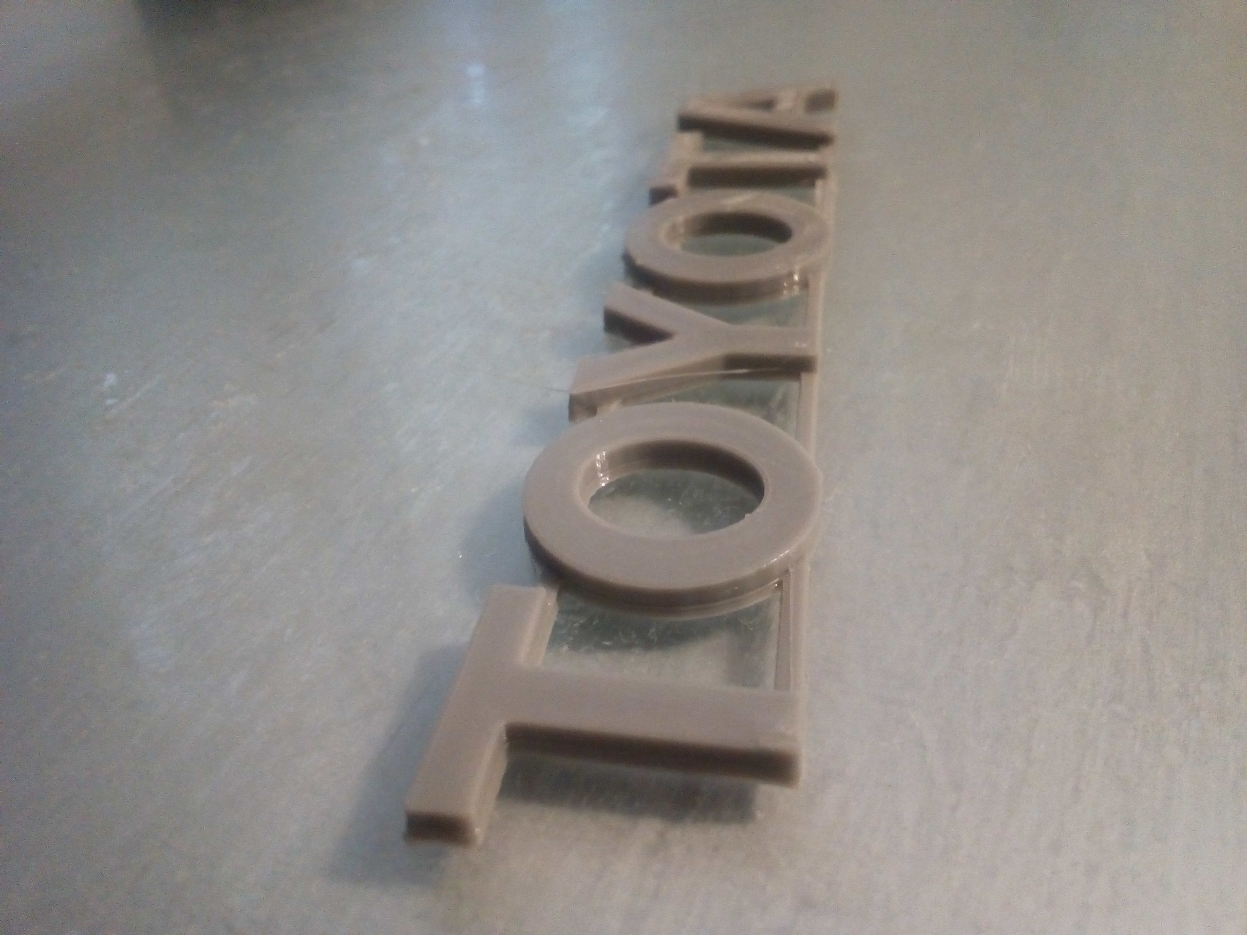

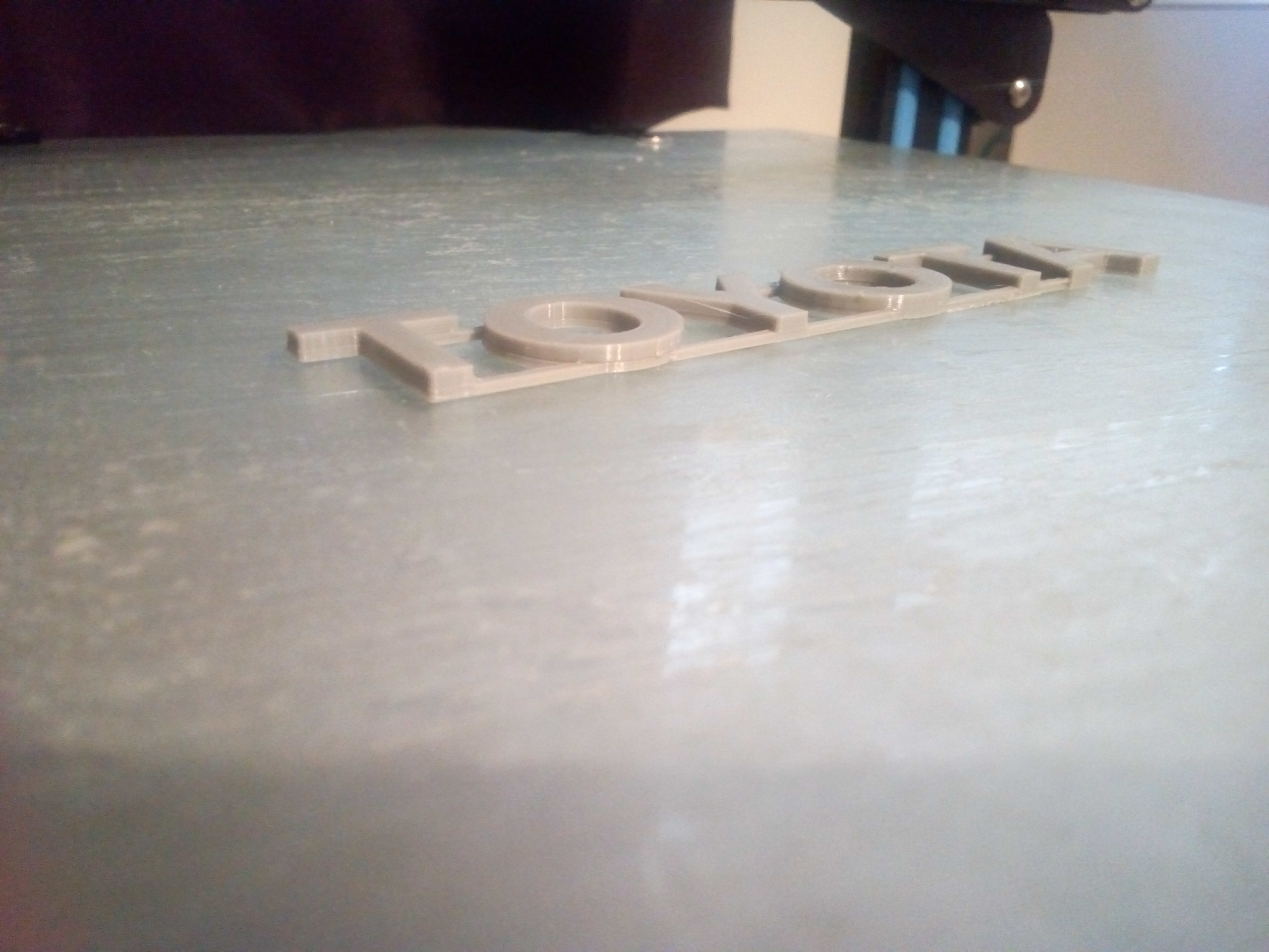

Printed this text using Cura, 0.2 layer height, 100% infill. It can be done.
