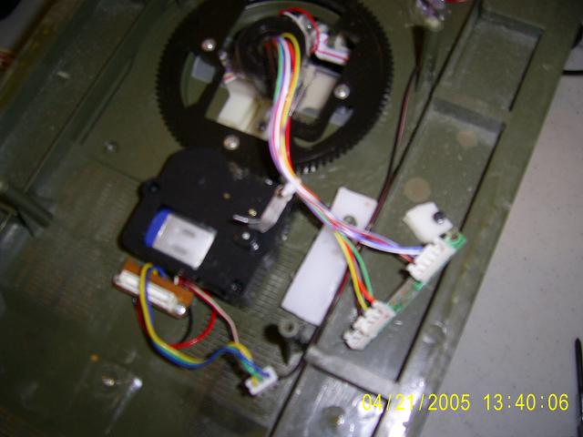

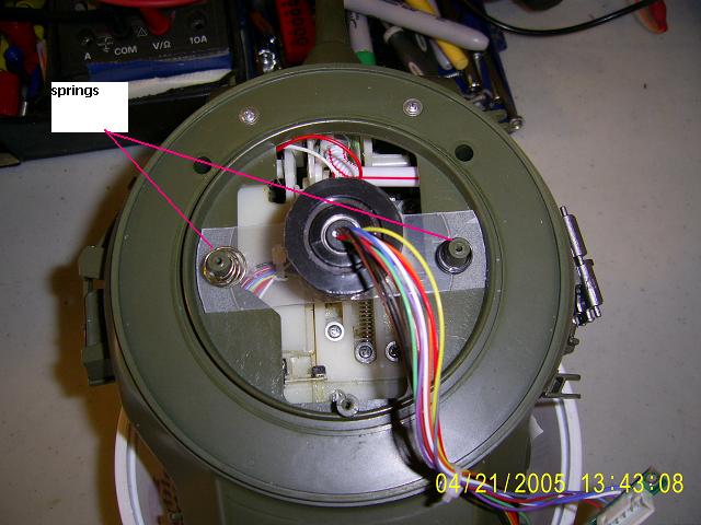

Finally made some early progress on the "smoking gun project" using my HL Pershing as a test bed ...( Replacing the Panzer IV) ...
The early phases of the project involved fitting an Asiatam recoil system in the Pershing( which was easier said than done ); and the installation of a 12 Wires 2 Amps Slip Ring for a 360 degrees turret rotation ....
The recoil still needs some fine tuning ; but the turret rotation is a blast .... :lolno: :lolno: :lolno:
Here's some early results ....

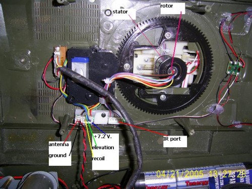

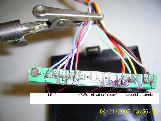

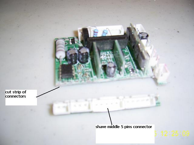

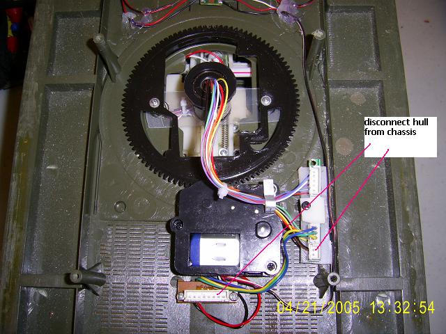

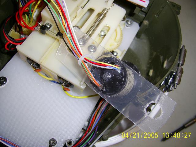

Here's the link on e-bay where I bought mine : http://www.ebay.ca/itm/Slip-Ring-12x2A- ... 2395wt_910
And here's a couple of pics how I installed it with an Asiatam recoil unit...

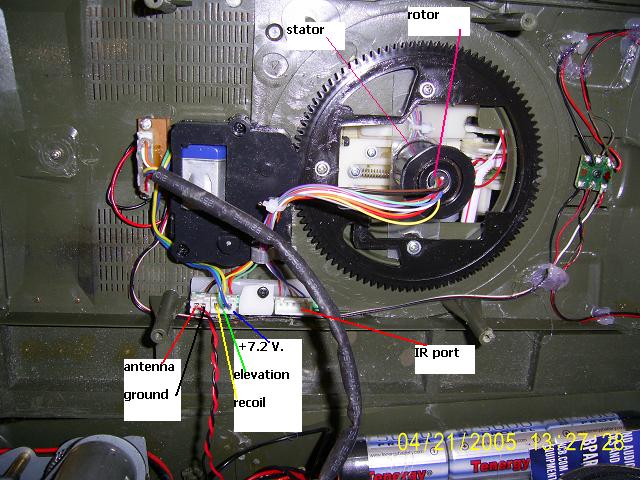

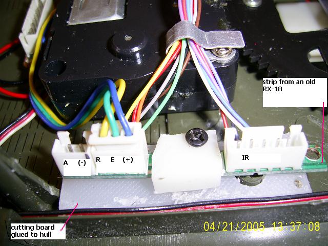

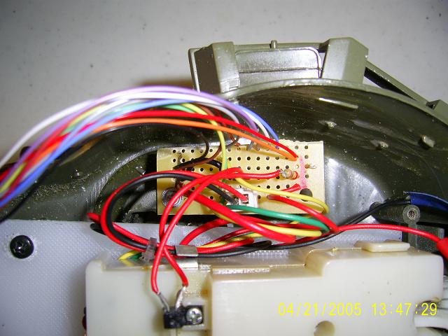

More pics... :haha: :haha: :haha:
