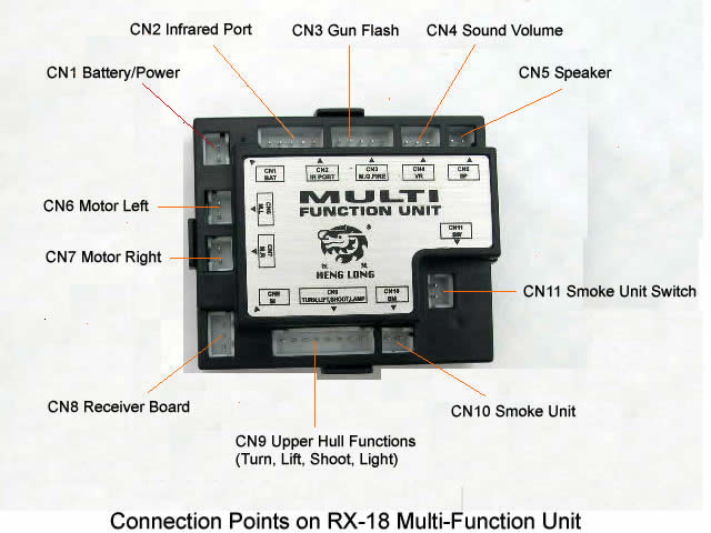

Most of the 1/16th are airsoft and in the past 100% were airsoft....I/R was not originally offered by Heng Long and Mato etc. and it is a relatively recent addition to the range. To convert a Heng Long to I/R from airsoft is not difficult but it would probably be better to buy a tank that has the recoil motor fitted rather than the airsoft, but the conversion is easy anyway. With the Heng Long make ABSOLUTELY CERTAIN that the control board is an RX 18 There are STILL some of the older tanks out there and to my knowledge the earlier boards are NOT I/R compatible !!...This is what you need to have.......................
As you can see the sockets are all labelled ( CN2 & CN3 at the top ) and it is I/R READY even if it is an AIRSOFT tank....which is important but It MUST be an RX18 board. I see on Ebay that you can still by the horrendous 'PanTiger' as it became known....basically it is a Tiger chassis with a panther body VERY BADLY stretched to fit....DO NOT buy one of those... The control board must almost be an antique by now... :haha:
