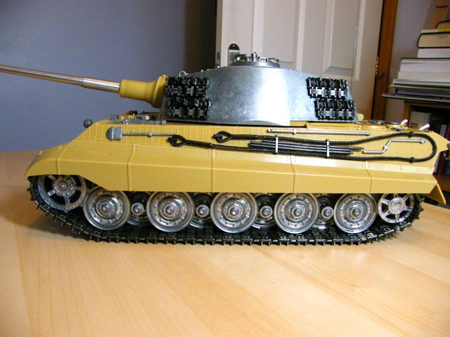

Hi chaps, thanks for the interest in this tank. Well it's in one piece now, current weight is 7.4 kgs, so a little bit to go yet before it hits 10 kgs. Blake is correct, the gearboxes are Asiatam 3/1 units made specifically for this hull, I don't know what the motors are, they are supposed to be high torque units. It performs well on carpet, no problem with neutral turns or quick tight turns, although I haven't had it climbing anything yet. I haven't ventured outside with it yet, my garden is too flat now and haven't had the time to find anything challenging to throw it at.
The choice of unit was down to decal set availability, although I do like the colour scheme Peddinghaus give for that vehicle, but the option of custom decal sets sounds interesting!. As for the turret base, this is plastic and the recoil unit came already fitted, looks like an Asiatam unit to me, I'll find out more when I pull it apart to find out why it isn't working! I'll take more interior photos when I strip it.

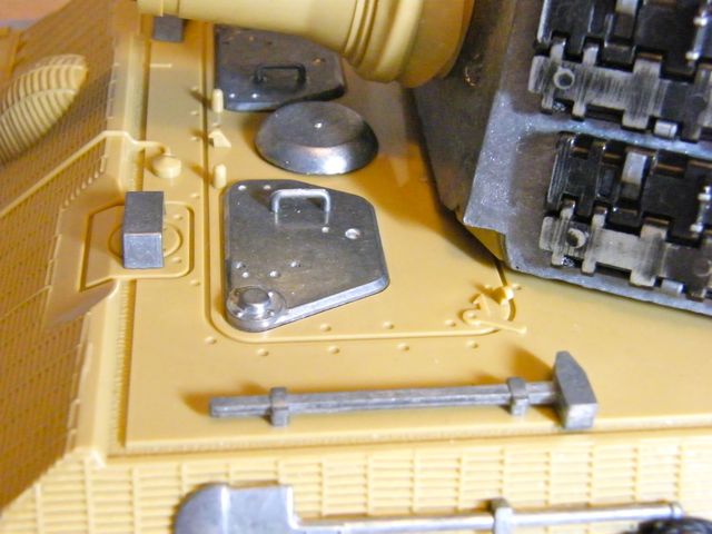

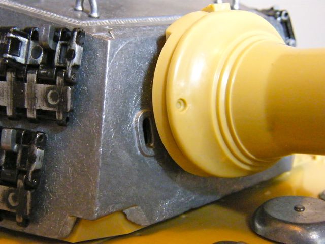

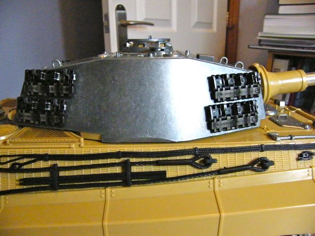

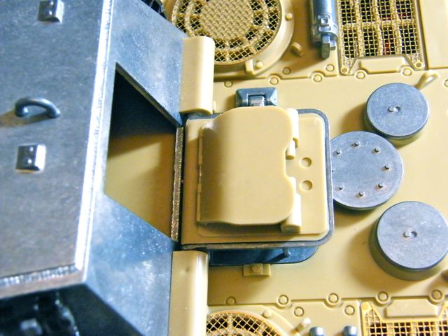

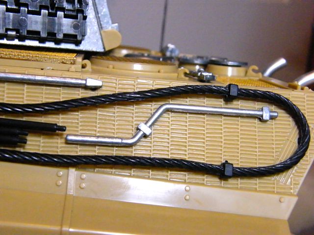

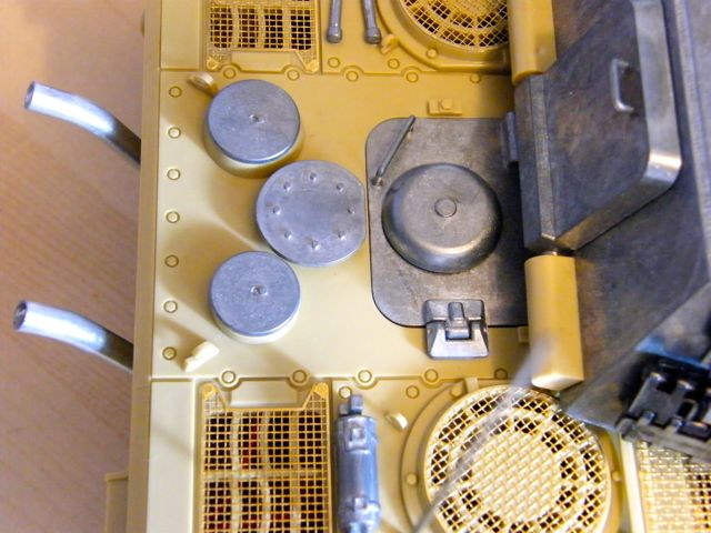

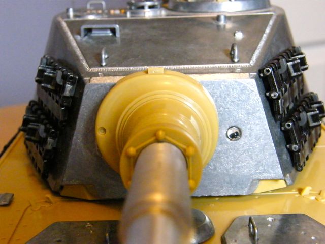

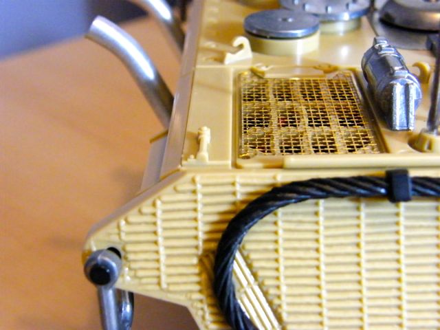

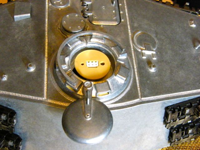

Here's a load of close-up photos, all pretty self explanatory. Torro have done a real good job on the details :clap: , the only obvious one missing is no pistol port on the turret rear door, although they put all the interior detail on, even down to the two handles hidden underneath the plate! Rctank.de have a metal pistol port with chain on their site, one is now on its way from Germany. The block for the commander's guide sight on the turret top is there, just needs a rod fitting, and there are two overflow pipes at the rear of the engine deck which need a piece of tube added to each to go over the side of the hull. Putting my anorak on 8| I have only seen one photograph showing a Tiger II with two overflow pipes on the engine deck, this is in the Osprey New Vanguard book number 1, Kingtiger Heavy Tank, page 12, all other pictures and drawings I have seen have one overflow only at the right rear of the engine deck.
The plastic tow ropes and track cable will get changed eventually and a Schumo anti-aircraft MG will probably find its way to the commanders cupola.
